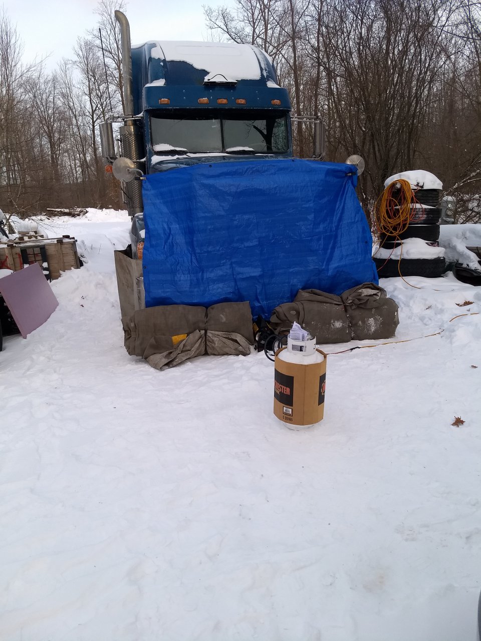

    Try this. Heat the motor with a torpedo heater.
    Block heater stopped working.
    Good thing I didn't wait to start until Monday morning at 6, when I was scheduled to leave. IMG_20210214_162737685.jpg

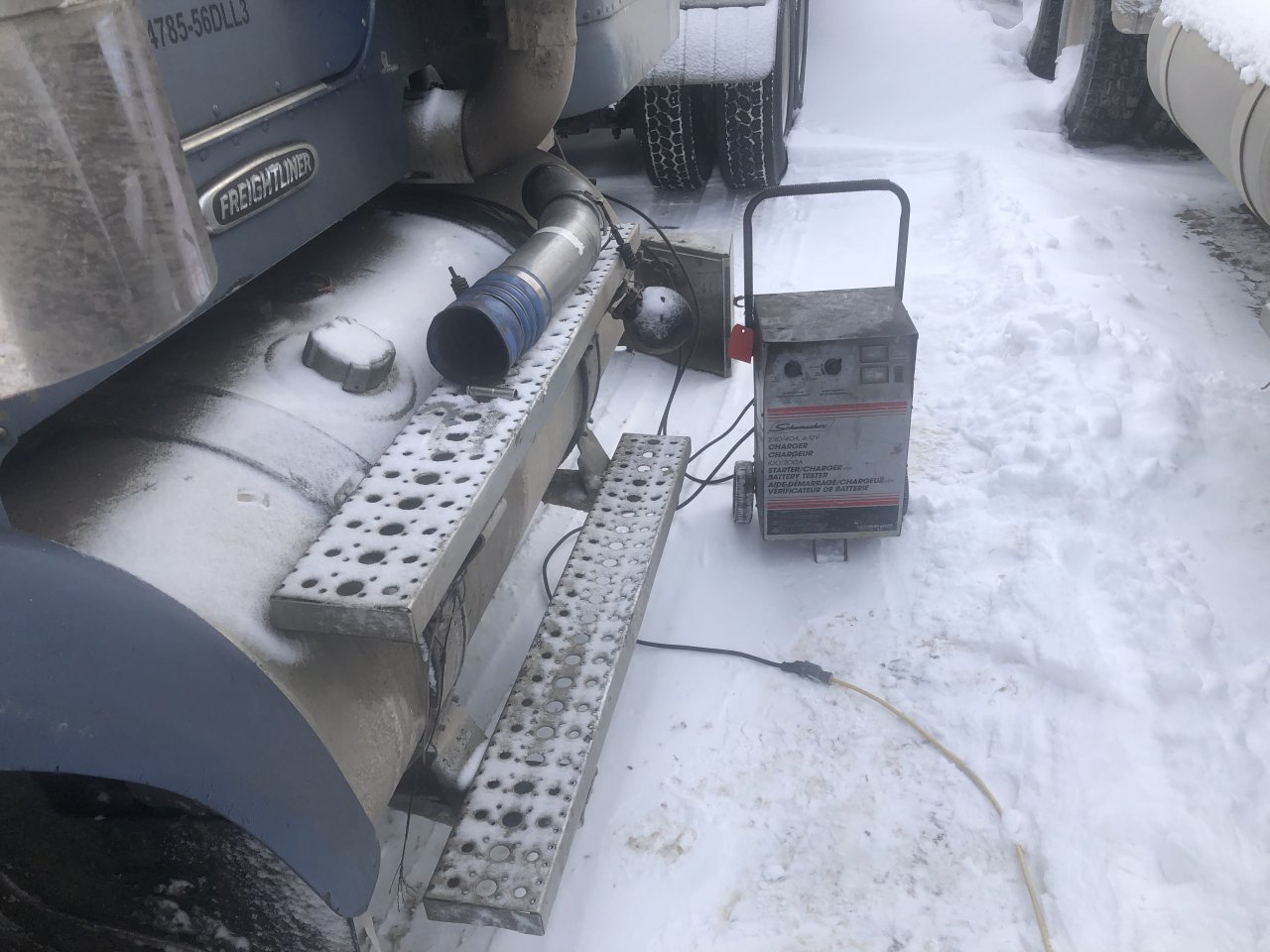

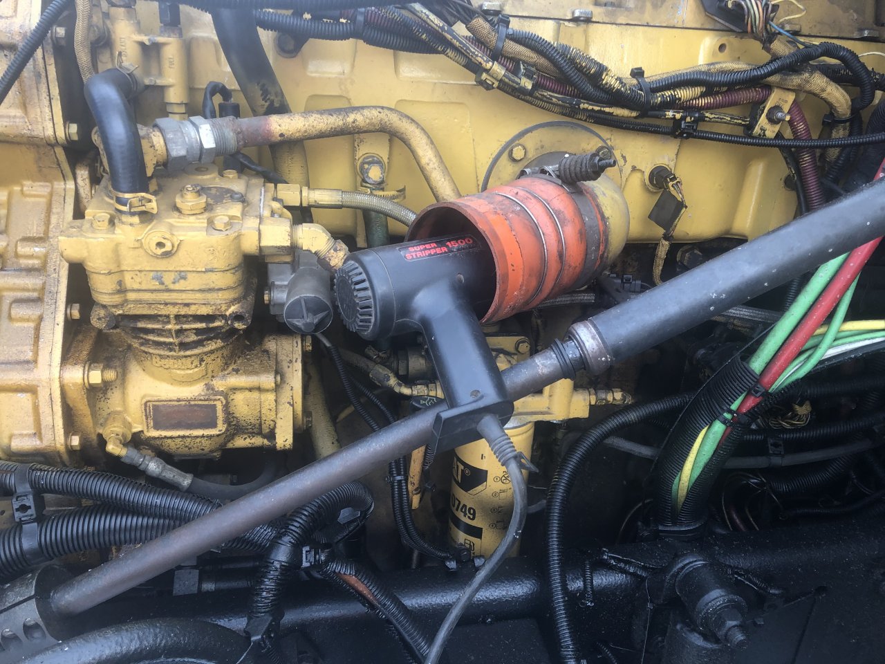

    Our temps have been down around -20°c (-4°f) with Wind for a while.
    When I need to get a truck going that has not been plugged in, I use the heat gun and battery charger.
    Warm intake air pretty much gets the engine running while the charger brings the batteries up a bit from 40% and helps to spin the starter faster.
    4B512767-5A40-4597-83B8-791389A7D176.jpeg 4940CE75-D6FB-4ABB-87B7-3DE9C9E56B8E.jpeg
    So far this system has worked well.
    I’m not sure how well this will work if temps were to plunge to -45°c (-49°f) like out west in Canada.
    All I know is, warm batteries work much better. Diesel fuel is more readily able to burn with warm air blowing into the intake.
    If our temps were to be as cold as out west, then likely we will switch to an engine oil that flows better at those temps to help turn that large engine over easier.
    The best one is plug the truck in. Block heaters are easy to replace if one fails.
    If the factory installed block heater can’t keep up with the frigid weather, then installing a 1,800 watt in-line coolant heater will help better.

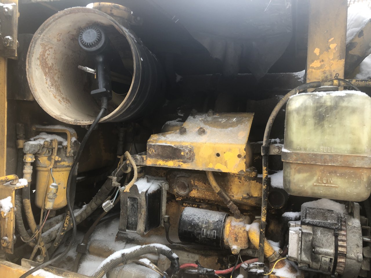

    Terrible.
    Someone forgot to plug our yard loader in after using it.
    I needed it, tried to start it.
    Just white smoke during cranking.
    I pulled the air filters, plugged in a battery charger and used the heat gun in the filter housing.
    Got the loader running.
  9. xsetra
    xsetra Road Train Member
    5,124
    7,006
    Aug 21, 2011
    I think I'll try your system this weekend.
    It looks easier than tarping my truck.
    Last summer I swore I would never tarp again. Not exactly what I meant, but!!!
    I don't want to try to change the block heater until I have a few warmer days off.
    Last time the block heater cord shorted out. I was going to also change the heater. The first bolt I tried to turn out. Broke off. So now the project has to be finished.
    My open air garage, (as seen in the picture) needs more heat
