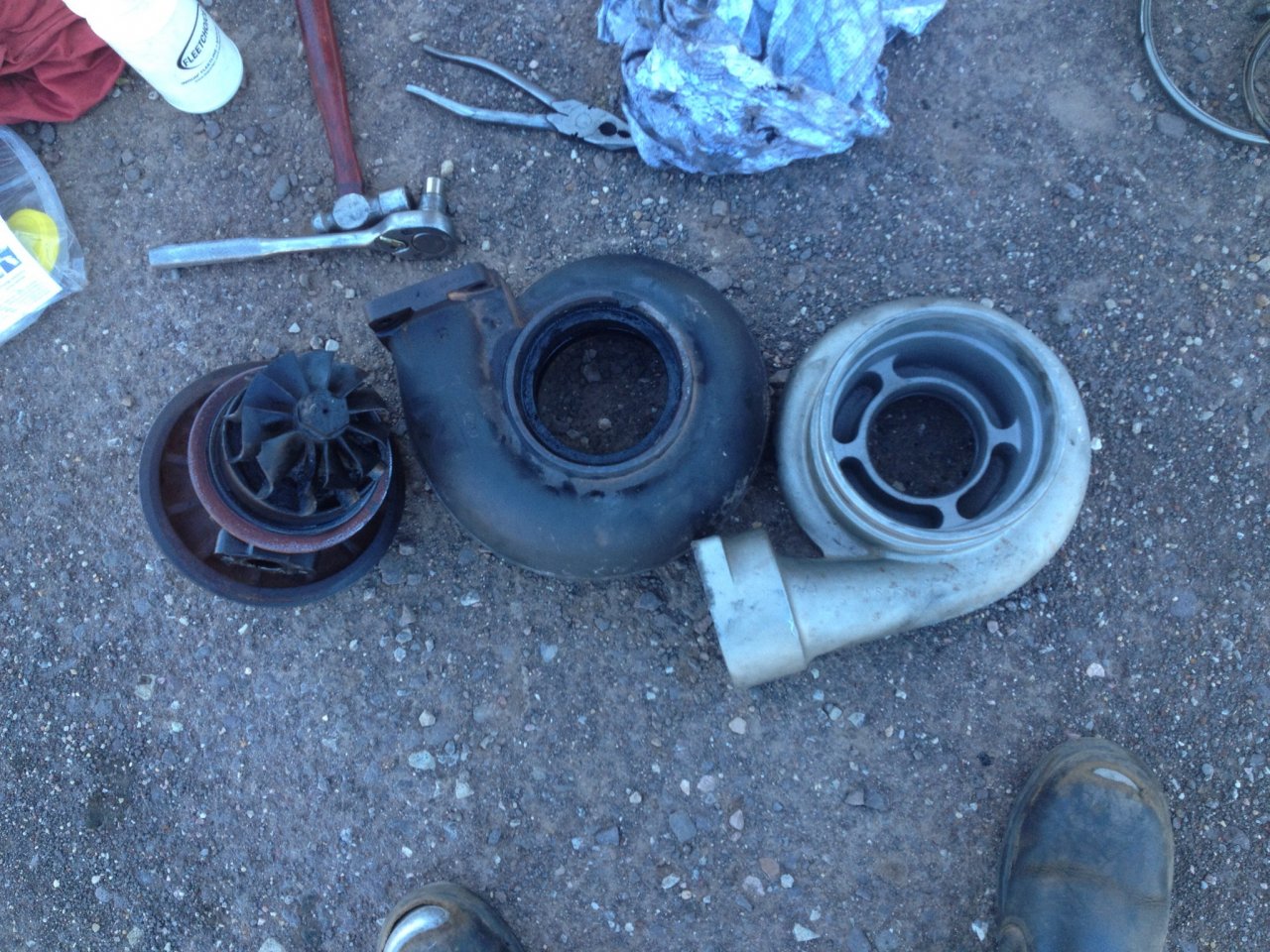

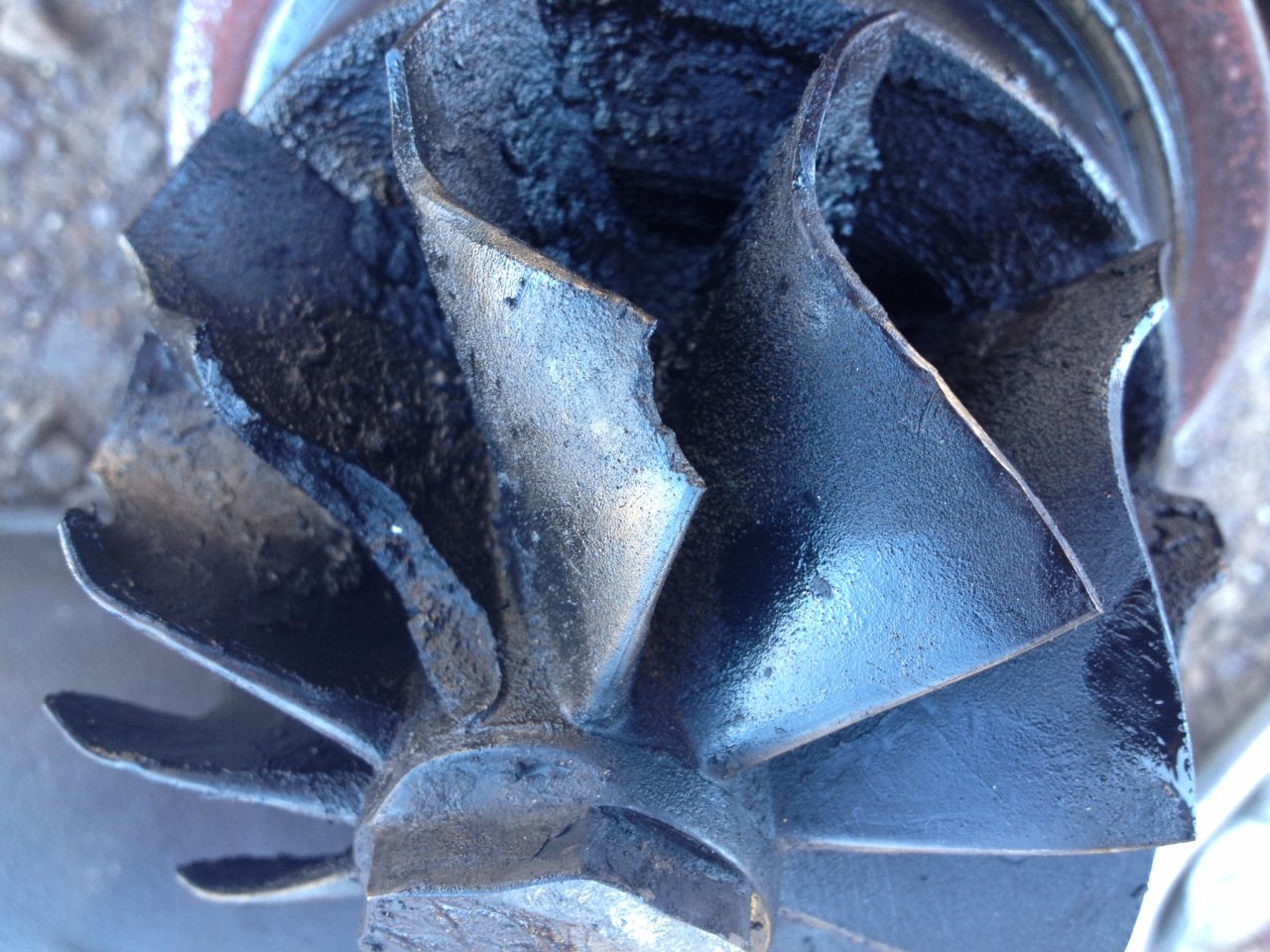

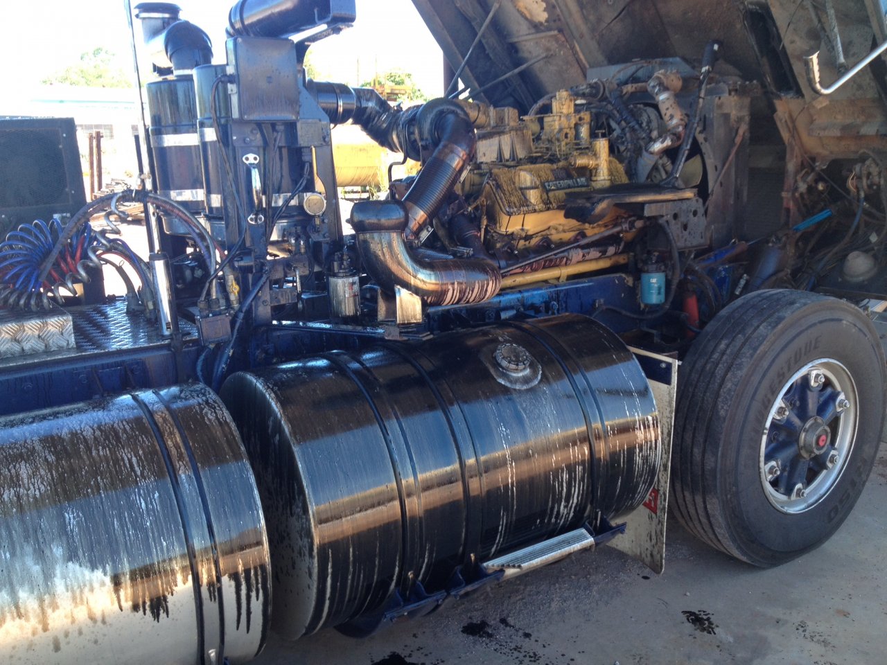

    This is what happened when I didn't check my turbo, like everyone says they let go at the most inconvenient time and mine sure did, in the middle of nowhere and I was doing an oilfield hot shot. If you think there is the slightest chance of a problem, replace it. image.jpeg image.jpeg image.jpeg

    Well I pulled off the boot for the outlet of the turbo it was dry. The oil supply line is leaking at the fitting into the turbo. So oil is spreading, slowly, on the out side of the turbo. I will get it looked at sooner than later.
