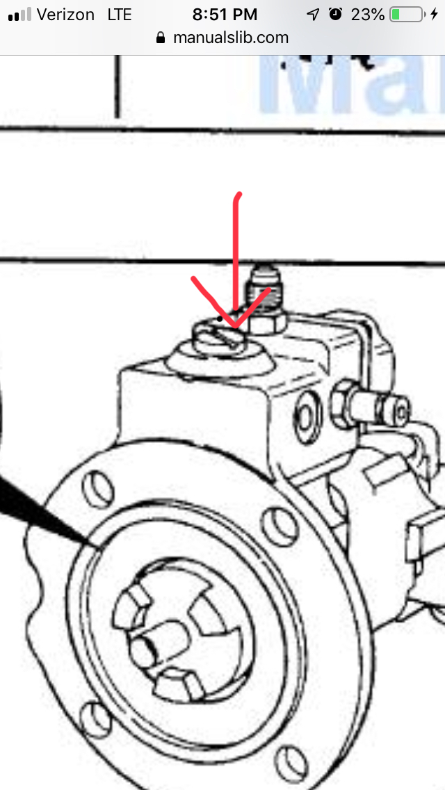

    I’m thinking it maybe a fuel issue. I’m sure you’ve tried new fuel filters. I would also be looking for a leaking fuel line. Please note a damp fuel line is leaking.
    Also there is a filter in the fuel pump many people overlook. It’s under a plug in the top of the fuel pump. It takes a flat head screw driver to remove. It’s primary use is to catch metal from the pump before it hits injectors with a magnet and fine screen. I’ve seen them build up with a tarnish that comes from diesel. You may start by replacing it if you haven’t looked at it yet.

    E1937BB6-16EC-496F-B78D-8A6BE12F7720.jpeg Found a picture, pump filter is under the plug with the red arrow above it.
