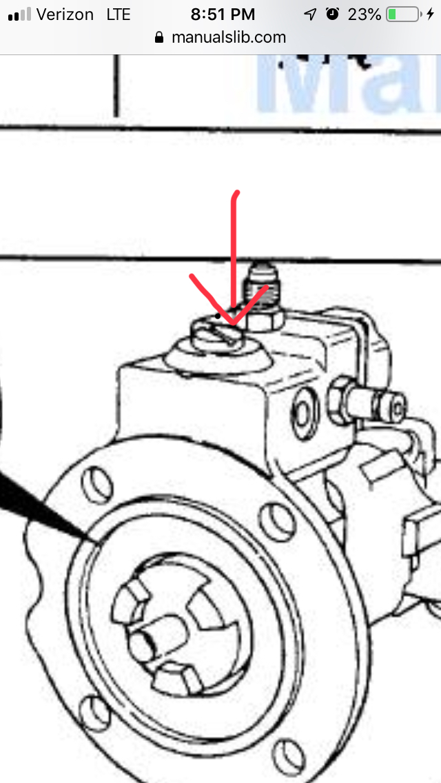

    On order from the dealer, it was one of the things I was considering as well so went ahead and ordered it when I picked up the EPS. The dealer called it a filter screen, part number
    146483, for anyone also looking.
    The fuel filter was one of the first things that got changed when this whole misadventure began :). Only reason I'm leaning on the EPS is because it'll run fine until you let it warm up, and then all hell will break loose. That and the fuel system looks tight, everything from the jumpers in the head to the fuel filter is dry as a bone.
