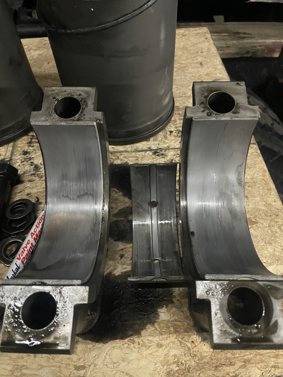

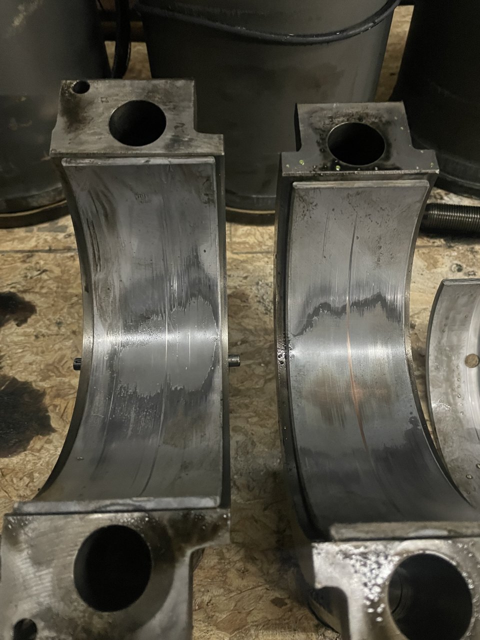

    Turned 1, 3, 5, & 7 mains loose and rolled out the tops. Crank feels much better than the bearings look. Felt for any scratches with my fingernail and felt nothing. I suppose I got lucky. Moved on to the oil pump to get it removed and dang some of those bolt are hard to reach. How many actually hold the pump to the front cover? IMG_5189.jpeg IMG_5190.jpeg
    Vampire, W923 and broke down plumber Thank this.
  8. W923
    W923 Road Train Member
    1,426
    4,421
    Feb 28, 2022
    Pretty sure it’s 5 bolts and certainly only the 7/16 ones (5/8 wrench)
    Sounds like you’re ok on the crank
    What about fretting on the main caps where they bolt to the block. as far as the oil pump if it has good oil pressure just make sure the gears aren’t starting to flake or major scoring on the housing and put it back together definitely put new o rings on the plug outside of the pressure relief…they like to leak.. get them from Cummins or get???viton??? Ones…regular black ones from a o ring kit don’t like the heat I guess and get hard fast.
    I hate cutting corners but I’ve seen to many people go broke fixing the what if’s that aren’t broken and don’t usually fail. The oil cooler I would either replace or flush due to possible crumbs waiting inside.

    you really need to check the mains for fretting before you order anything.
