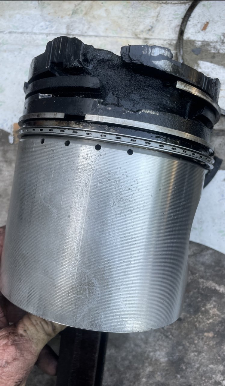

    I promise it will have a lot of blow by even at idle if it’s a bad piston….

    You’re probably correct that a piston broke. based on his comment about having an ecm he almost certainly has steel top pistons with aluminum skirts. They tend to just split down one side of the steel top instead of breaking up like yours. it will still let enough by to cause his problems…that’s a good one you got in the picture though, maybe one of the best I’ve seen.

    Started sounding like the little man with a big hammer about 80 miles from home. Ring worked its way up got embedded in the top of the piston from being smashed against the head.
    I was fortunate it never touched the injector, did leave some marks on a valve along with taking the edge of one valve off.

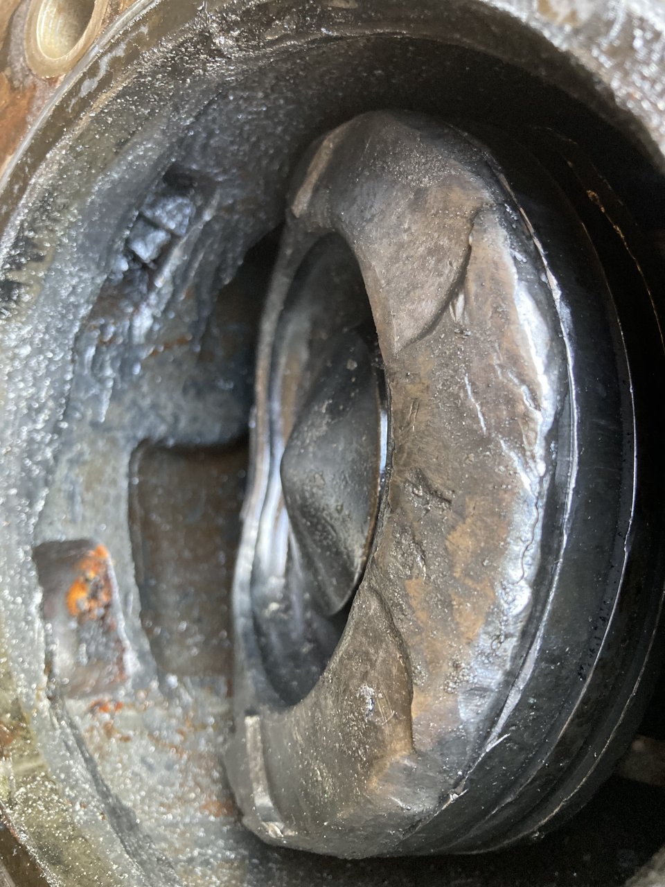

    You mentioned steel top piston, I drug a truck in from S Carolina with my 5th wheel wrecker few years ago. It had a N14 with steel tops and making a chattering noise.
    Steel top actually broke loose from the wrist pin on it….

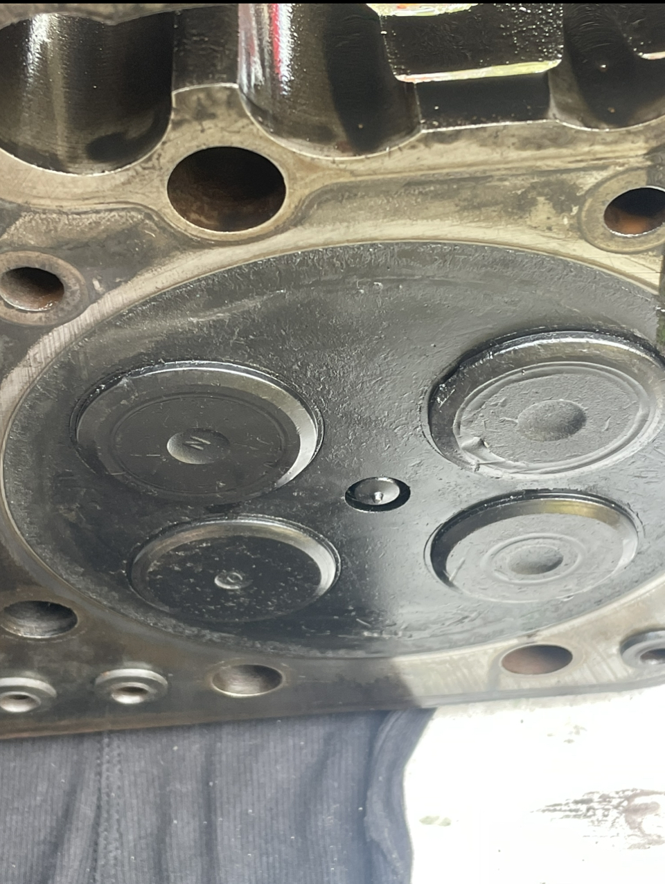

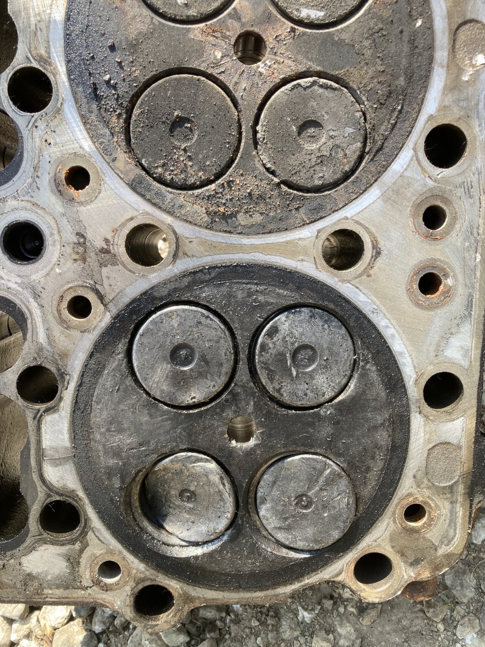

    lets just hope it looks better than this…
