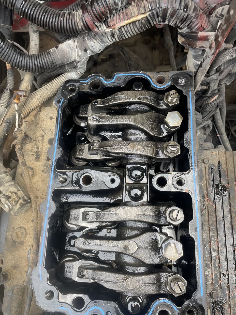

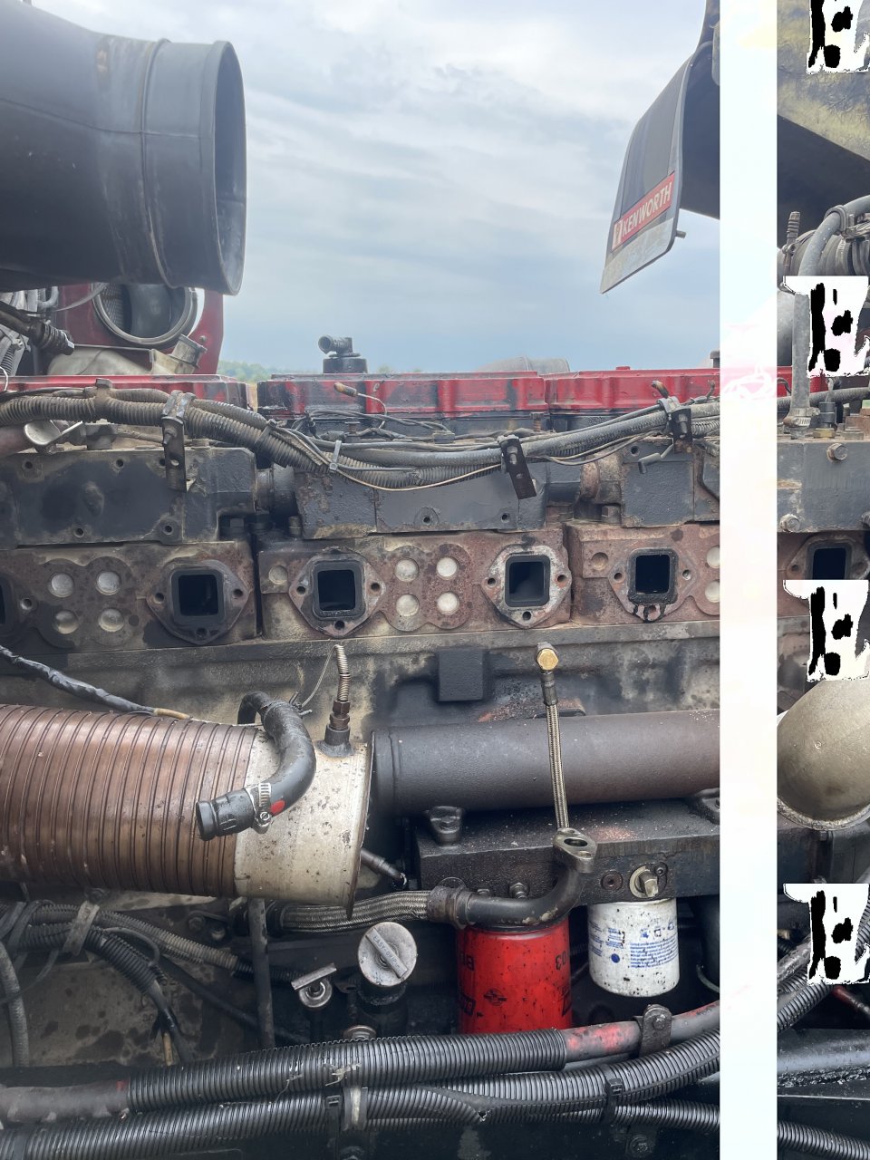

    Started tearing into it and doesn’t look to have a valve out of place. Looking through the boxes I can’t see anything out of the ordinary. Removed the manifold and the exhaust ports on the front head have oil inside them. That said, with the crankcase pressure it had, along with blowing oil through the front main and possibly the accessory drive seal, was it most likely pushing oil towards the turbo through the return line, flooding it with oil?

    Here’s some pic though not the best. IMG_4504.jpeg IMG_4503.jpeg IMG_4502.jpeg IMG_4501.jpeg

    It looks like number 2 is considerably more oily than the rest. Might be an indication of a problem or just sucked in more oil from the turbo than the others. It would appear in the pictures that everything up top is ok. You might have to start pulling heads to look for the cracked piston. It might or might not be pretty obvious. Do you know any history of this engine

  10. W923
    W923 Road Train Member
    1,390
    4,263
    Feb 28, 2022
    Have you tried running it with the top off and see if one rocker box has more steam rising from it?
