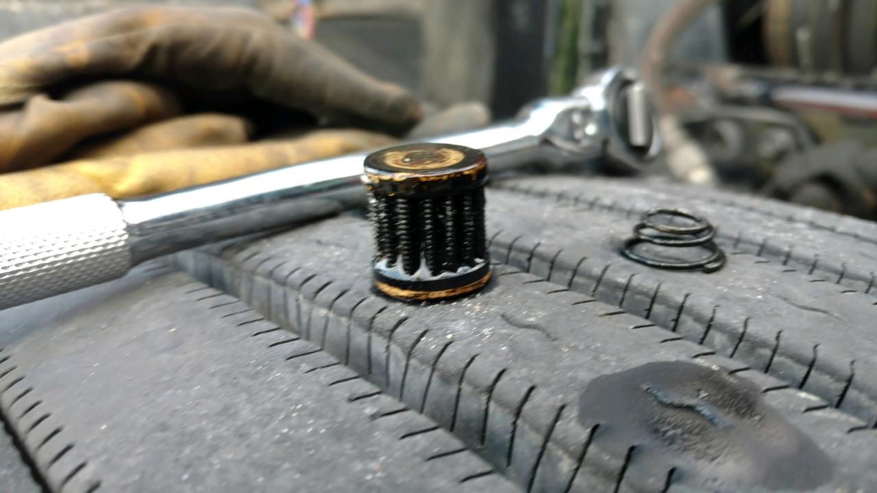

    Well, I also had the #2 injector replaced (just in time). It still didn't run right so I dig a little deeper. Here is what the fuel pump screen looked like when I pulled it out. 12498.jpeg

    Is that algae? Or just junk?

    I think it's just junk. I was able to clean off about 60% of it. I will replace the whole thing when I get home Sunday. I know some say to use some brake cleaner on it. But for the small cost, I'll just get a new one and go from there.

    Not many look at that filter. Some don't even know it exists.
    This reminds me to look at mine. Been a while.
