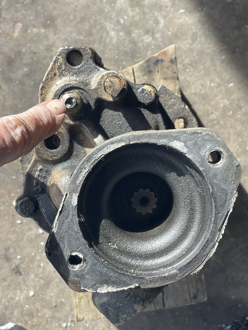

    Walked in the shop again and seen this old pump, it dawned on me…. Pull that plug out and pour you some oil down in it slowly and you should be off to the races. That goes right in to the gears…
    Oxbow and mile marker 27 Thank this.
  4. OLDSKOOLERnWV
    18,468
    278,560
    Same plug, actually a quick connect for checking pressure etc….
    mile marker 27 Thanks this.

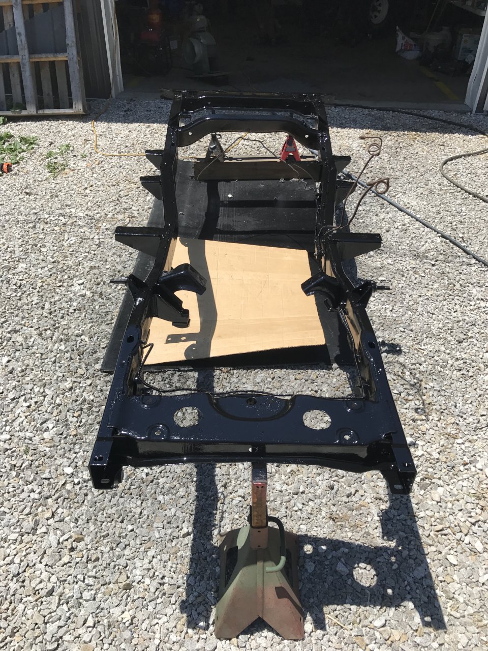

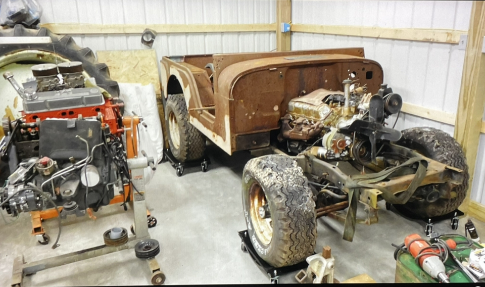

    I have an oil pressure gauge under the hood on my firewall. If my engine is ever apart I add oil with the 12 volt pump and pressurize the whole system before starting the engine. Just something I do, not that it’s required, but I know where the oil is and isn’t.
    When I pulled this Jeep engine apart after setting for 28 years, there was still oil on the bottom rod and main bearings. Many say that if a engine sets for a year there’s no oil at all in the bearings. That has not been my experience 100% of the time….
    Oxbow, Flint1 and mile marker 27 Thank this.

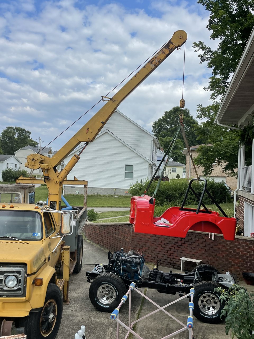

    Originally a 1977 CJ5 Renegade Levi’s edition, blue on blue. I have the blue Levi seats, dash, sun visors in the shop. The 3 spd was locked up from setting and rain going down around the shifter, so I bought a used T18 Borg Warner 4 spd out of a 78 CJ5. Worked on it from 2017 till august 2024. Got some little things to tidy up, but it’s running and driving….
    IMG_9717.jpeg IMG_5206.jpeg IMG_9009.jpeg IMG_9011.jpeg IMG_9005.jpeg IMG_9008.jpeg
