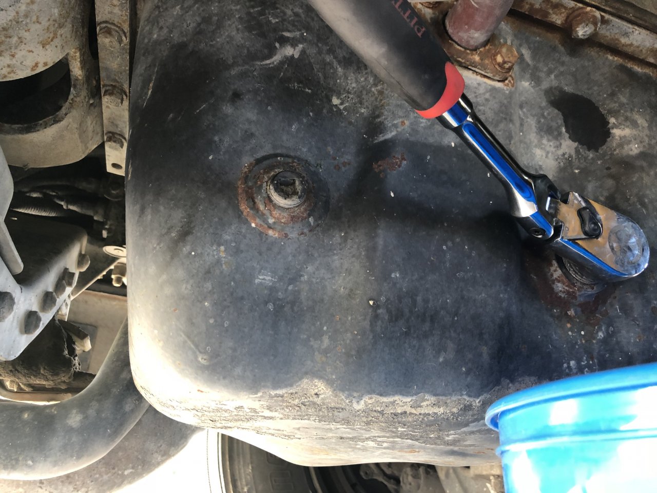

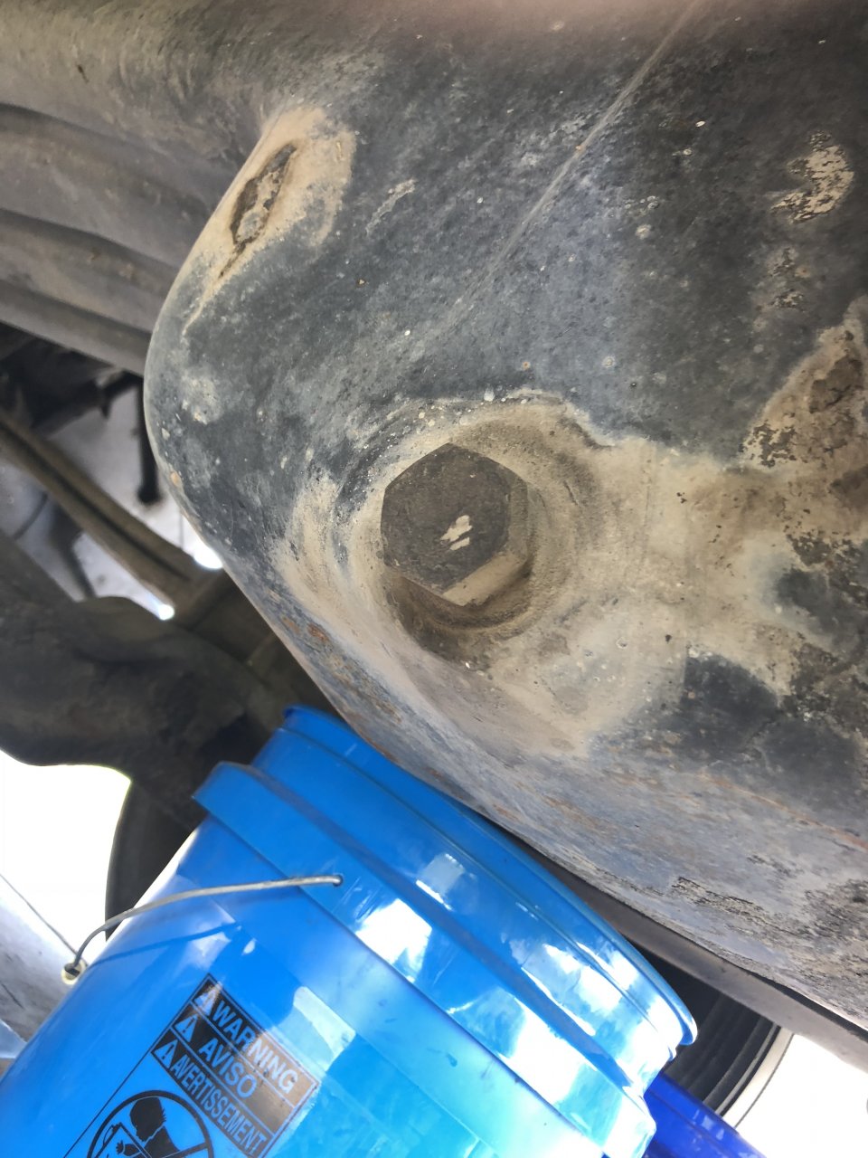

    C77BF5BF-99ED-4847-AA68-4B86A472B8A8.jpeg 7B9E1D3E-BBD0-4AD8-B24F-262E7FB38068.jpeg Ok, so here’s a nice stupid question. Which port do I drain the oil from? The 1/2 drive on the drivers side? Because it’s on mighty tight. The 1/4 on the drivers side? Or the port on the exhaust side?

    The one that's the lowest part of the pan at the bottom

    The one in the top picture just above the blue bucket. The big one.
    And you better have an extra pail real handy or you are going to have a big mess. You are going to drain over 10 gallons. I would suggest you go to Wal-Mart and but a cheap cooler with at least a 44 quarry capacity. Handles on each side for lifting, and drain plug on one end for draining the oil back into jugs after you put new oil in the engine.

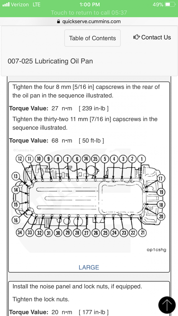

    Here’s the torque order if you didn’t have it already
