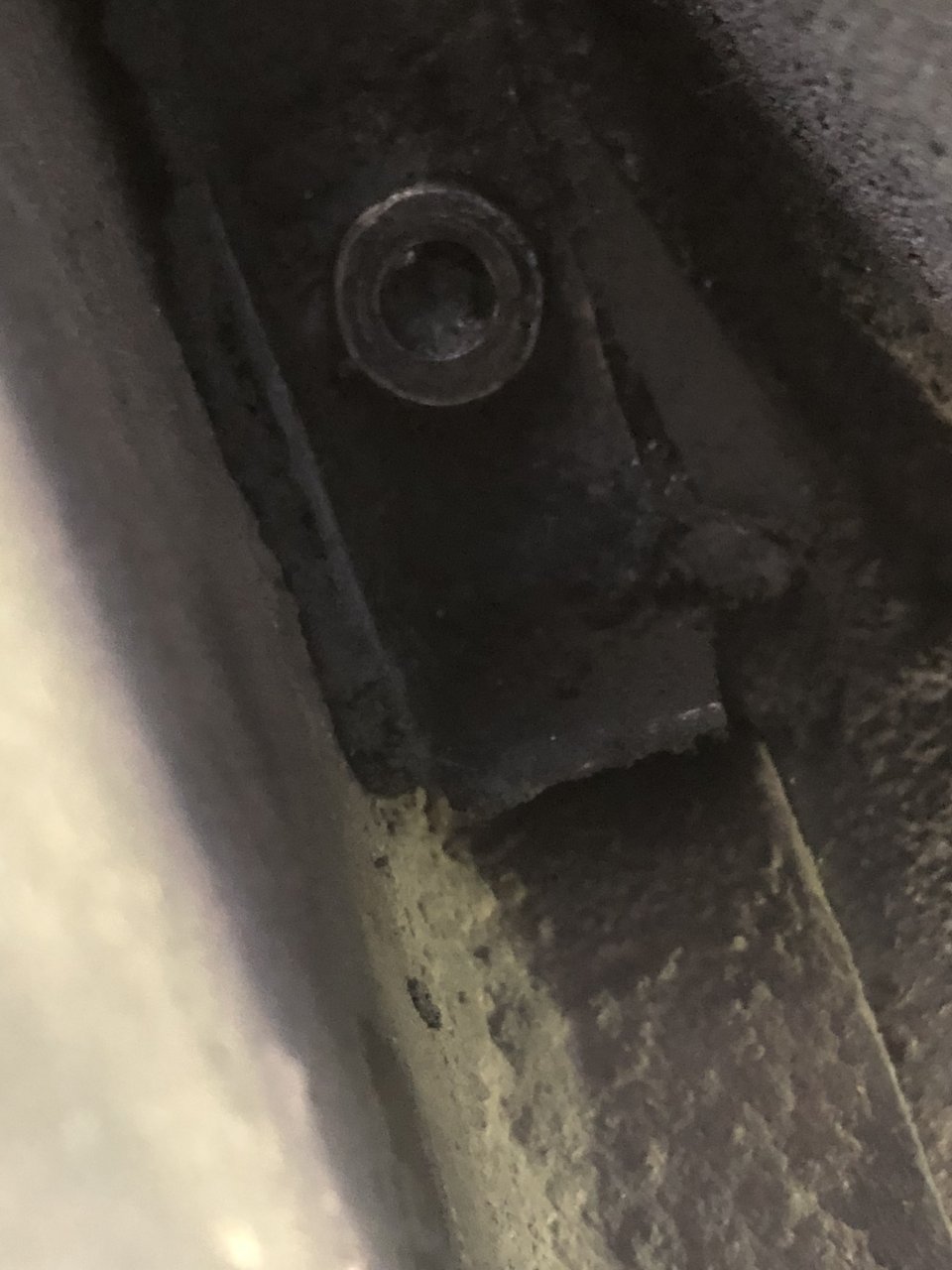

    7AC142F8-6769-47BB-801A-324D33FC2D6C.jpeg 87AE6E84-988F-4D20-A544-80041FBC68E4.jpeg Question: does anyone know what the deal is with the back of the oil pan? It looks like a different style bolt and I got the rest of the bolts of but it still seems held down with the back bolts, the ones toward the transmission
    Do they need to come off?

    They are torx or allen head, can't remember.

    Ok thanks. They look completely rounded on the inside?

    Mine were torx on inside, makes it much easier to get them started going back in. And 1/2 inch socket on outside to remove and torq down. Can't tell if yours are both or not.

    Nice. I see the torx now. Got three to break loose and got one that’s basically rounded out :(
    Any ideas? I’m going to go like at Home Depot or fastenall for easy out options
    Edit: my local shop (good guys) gave me a grinded down 1/2 socket that should be able to fit behind that bracket to pull the bolt. We’ll see!

    Try an allen wrench socket, sometimes an allen wrench will work in a rounded torq. My back bolts were both torq AND regular hex head that 1/2 inch socket fit on. Took them out with half inch socket then started them back in with torq bit socket by hand and extension then torqued then down with 1/2 in socket.
    Cummins might have replacement bolts like mine. Fastenall might as well.

    Yup the ground down 1/2 socket worked like a charm. Time to pull the pan now, got just two bolts holding it up.
