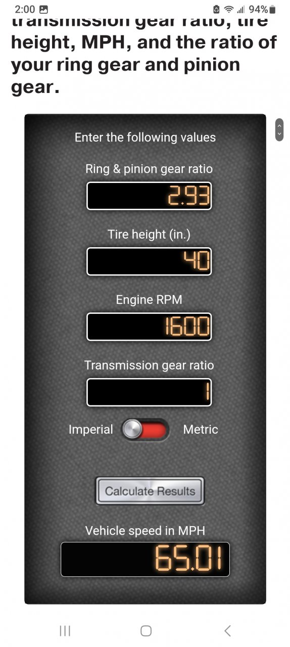

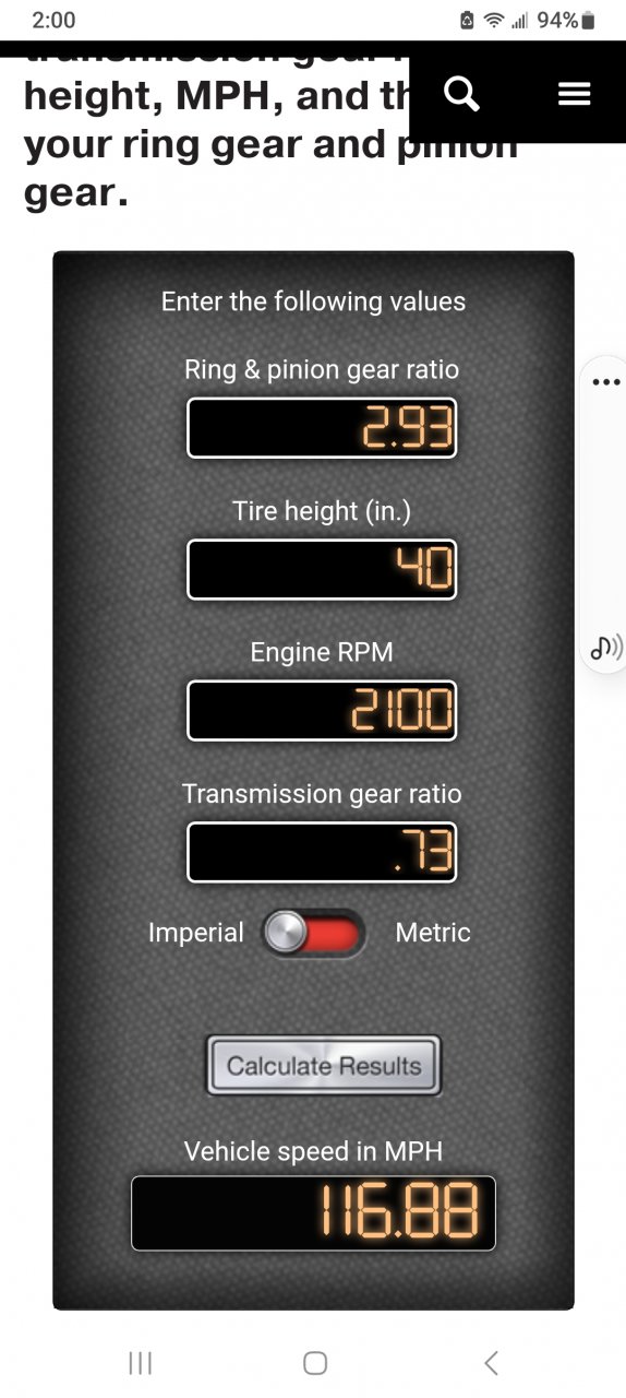

  11. singlescrewshaker
    4,794
    41,786
    Dec 31, 2017
    Little Havana, FL
    Got yourself a triple digit hammer of truck now!! Lol
    Seems to me the mechanic put in the wrong 13sp for the rears you got.?
    Can only guess from the speeds/rpm you mentioned you have something like a 16913A transmission?
    11th being 1:1
    12th .86:1
    13th .73:1
    That's too deep of an overdrive for 2.93 rears, & the truck probably has start ability issues in 1st, possibly making you use the low hole to lift off.?
    https://www.google.com/url?sa=t&sou...YQFnoECBcQAQ&usg=AOvVaw2oZ1SK9kl8sKePkoKDHH9O
    You'd be better off with an RTO 15613. That's basically a direct drive 9sp with a overdrive back box. You end up with 13th being .87:1 for your final ratio. Gives you perfect rpm for a Detroit running 65-70mph in 12th, 1:1. And good rpm for 70mph + in 13th, .87:1..
