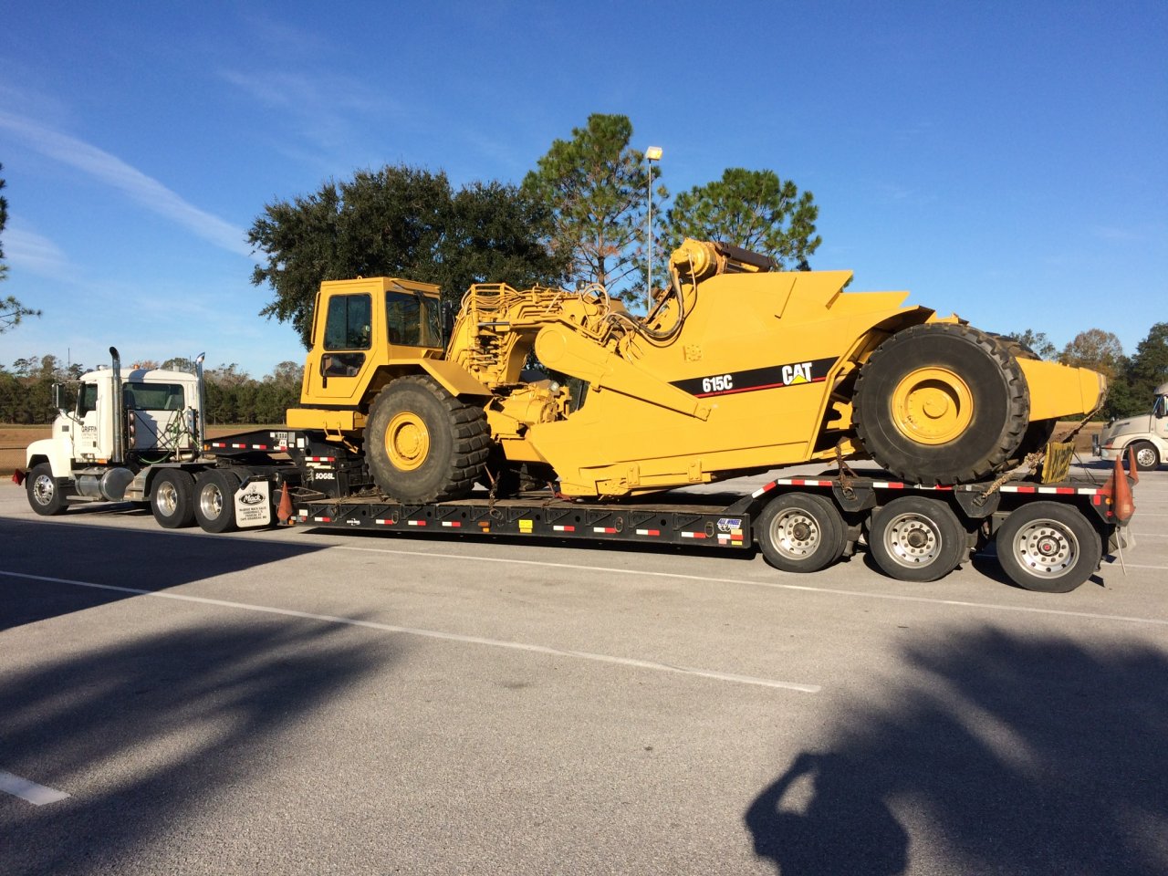

    What year is the white one pulling the low boy? Don't worry about the Jake's they don't do too much besides make noise Lol. Better than sticking your hand out the window though.

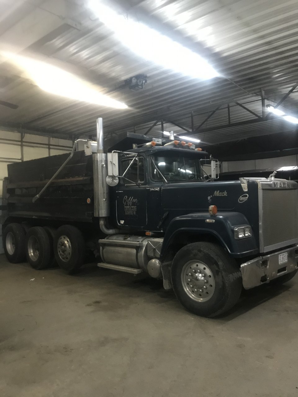

    I think that truck is an ‘08 model. He had two of those detach lowboys but I bought the other from him. My FIL’s uncle(Griffin Contracting) is who owns the Mack trucks. 4 dump trucks and two road trucks. The Superliner is the only one I like. The rest are just late model plastic Macks. The engines in the newer ones, have “Renault” stamped on them.

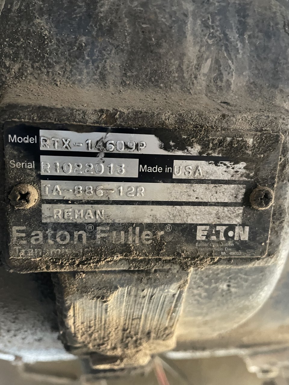

    Ok, sorry it took so long to get you the transmission number. I’ve been planting corn and it’s been some long hours. Here it is. A6E4CB8D-C5FE-411D-AB56-E90DFE06A8F8.jpeg

    That ain't no 10 speed!! It's a "Performance" 9.. I got one too, but mine's rtx14609R..
    Difference is your "P" has a .83 OD, my "R" is .80..
    Can be shifted like a 10, but the 9 hole in low range is basically redundant to 5th..

    When I bought the truck several years ago, the owner, which only owned it for a year or two, said it was a 10. I drove it just like a 10. After I bought it, I changed all the fluids and noticed the transmission tag and that it said it was a 9 speed. I drove it like a 9 and it definitely felt like I was skipping a gear. Not sure why it feels that way but I don’t like driving it like a 9, with a load. Maybe it’s the 12.7, maybe it’s the rears and maybe it’s both but it does not feel right skipping that hole and that said, it just doesn’t feel like a duplicate of 5th. Appreciate the info.

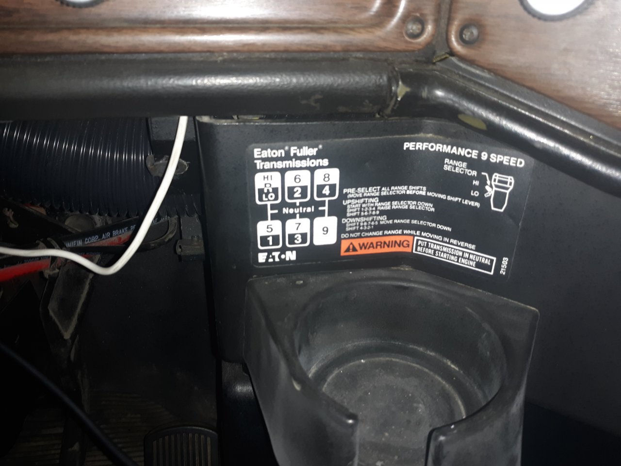

    - It technically does have 10 foward progressive speeds, eaton fuller just decided not to market it as such..
    -And I did the math on your ghost gear. It is a better step than mine at .4 ratio taller than your 5th is. (Remember our trans are labeled like this) 20211013_224405.jpg
    My ghost gear is only .26 taller than 5th. Probably why it's unnecessary for me?
    Drive that girl however she works best. Sure it ain't hurt'n a thing. I only tend to use my ghost gear in traffic when I'm too lazy to flip the range up.. lol

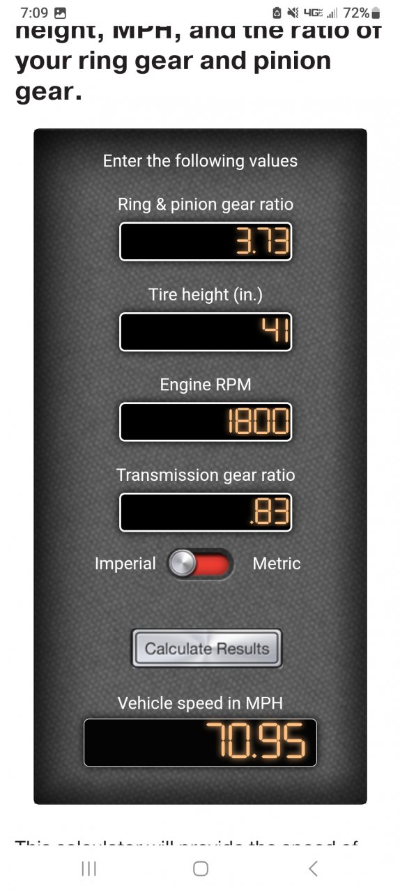

    Mine is
    350 M11
    DS404's with 3.70
    low pro 24.5
    similar trans, but slightly deeper OD at .80 so does 70mph at 1700
