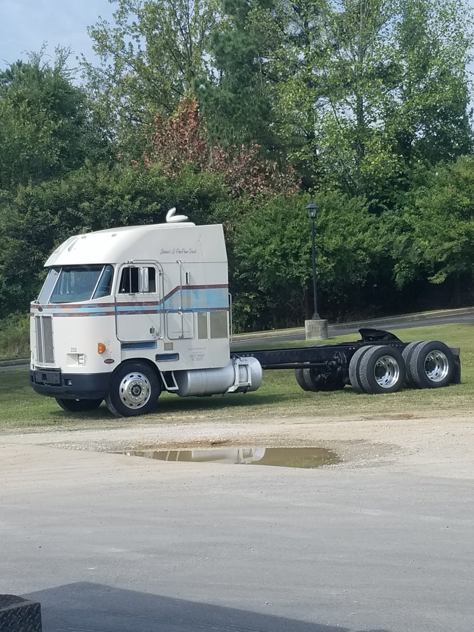

  7. KANSAS TRANSIT
    KANSAS TRANSIT Road Train Member
    4,080
    6,845
    Jul 28, 2011
    Glasco,Ks.
    We are going to find out how aero one can get, as I have already found someone to make me a one piece wrap around windshield, already purchased late model no wing window one piece glass doors from a late model 389, and am looking into a Stoneridge Mirror Eye in cab mirror setup to do away with the outside mirrors, have already, moved air tanks and battery boxes from outside frame frame to inside, in-between frame rails, air intake was cut down from over cab and relocated within the engine tunnel, and the "stacks" were removed in favor of a weed burner exhaust system. Front bumper will get a slightly reconfigured lower one, front head light buckets will be flush mounted, Gearing is getting reworked along with all new LRR tires. Keeping the BC4, but will be upgraded a bit to a mech N-14, fuel tanks will be modified for an in tank step and slide forward closer to the front tire to close that gap, side step will be eliminated, all that along with some other little things here and there, should be slicker than snot on a door knob, lol[​IMG]

    You gonna do something with that turn signal that sticks way out ?
    the air intake drawing in air that’s been through the radiator would be better getting in in cold air
    and start a thread for the build.
    I’d love to follow along
    Rideandrepair and KANSAS TRANSIT Thank this.
  10. KANSAS TRANSIT
    4,080
    6,845
    Jul 28, 2011
    Glasco,Ks.
    The turn signals on the front will be incorporated into the headlights on the side they will be "in" the cab step cutouts, will do a build thread, but my build threads sometimes take a while.
