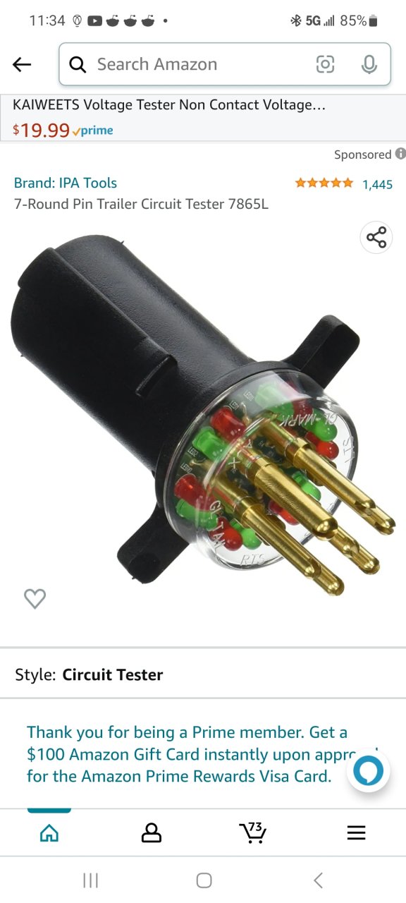

    You are talking about one of these right?
    So far... When I use it... I'm fine..
    Used it several times to test the tractor so far..

    Tests show no issue... If you mean using a multimeter and checking no I have not so far.... Don't actually know how to properly.... Electrically handicapped...

    This is what I was talking about
    so if the lights work on the tester , WHILE it’s plugged inline with the trailer and the trailer lights are not working , then the issues would seem to be with the chassis
    Or the voltage on the tractor is so low that it is enough to light the tiny LED lights on the tester but not enough to work the lights on the trailer .
    you mentioned some trailer lights were dim ,
    So I’m guessing this was an older trailer with non LED lights ?
    If the older non LED lights are dim , that’s a classic symptom of low voltage or a bad ground .

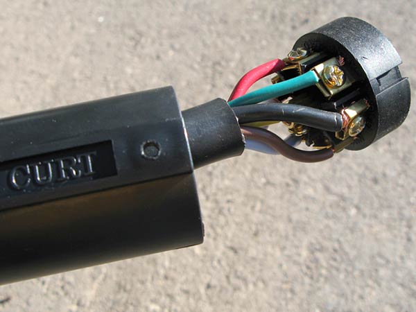

    It is up to you to run it or not.. It could be a bad trailer if it is working now.. But i think u have a wire loose somewhere or bad ground... When replacing a cord to a plug, it is easy to not tighten the screws all the way or to accidently get a wire loose when putting the rubber boot back on... Just to clarify you checked to make sure all the screws and wires are sitting tight on the back on the truck side plug ? if any of them are loose it will cause flickering or work intermittenly especially the ground wire which will be the thick white one at the top of your plug. Red is the brake lights

    That 7 plug tester lit up like a Christmas tree.

    I don't own one of those testers I was using it at the shop as we're they when they double checked what I checked...
    You are saying plug it into the trailer and plug my line into that and if I light up green on the brake but the chassis doesn't light then it's definitely the chassis?
    Is that like I can say to the shipper "here is absolute proof the chassis is bad and not my truck" kind of thing?

    You need a test light to test individual wires. You can buy one at most truckstops. I have a simple one like the picture below and i also have one that has a voltage readout on it. What you do is take the clamp and clamp it to a piece of metal that is conductive (not aluminum).. If you are working around the truck and trailer plug. A bolt on the shocks or fuel tank strap bolts will provide the ground you need.. When u have a good ground with that clamp, then u touch the end of the metal probe to the wires and the light should come on if you have power... Now the voltage readout one is better because it will tell you what volts you have coming thru that wire... If you already tested the plug with the 7way tester then u really dont need to do this because you are just doing the same thing....
    Maybe the problem is on the trailer... If it is working intermittenly.. But i would recommend getting a phillips screwdriver and making sure all the wires are screwed in nice and tight to the back of the plug on the truck and that there is no corrosion back there... The back of those plugs are always a source of electrical gremlins . i have replaced a lot of them
