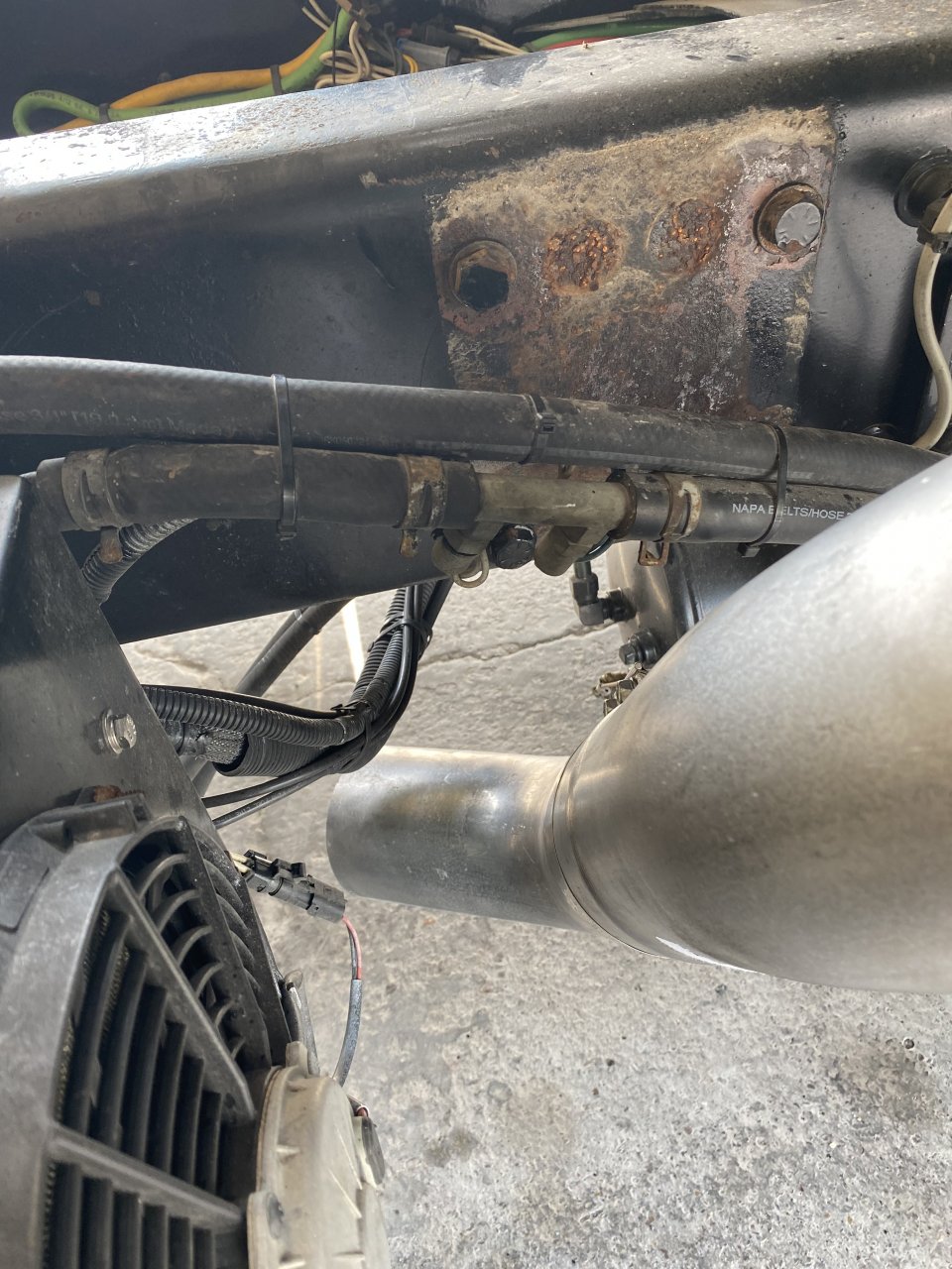

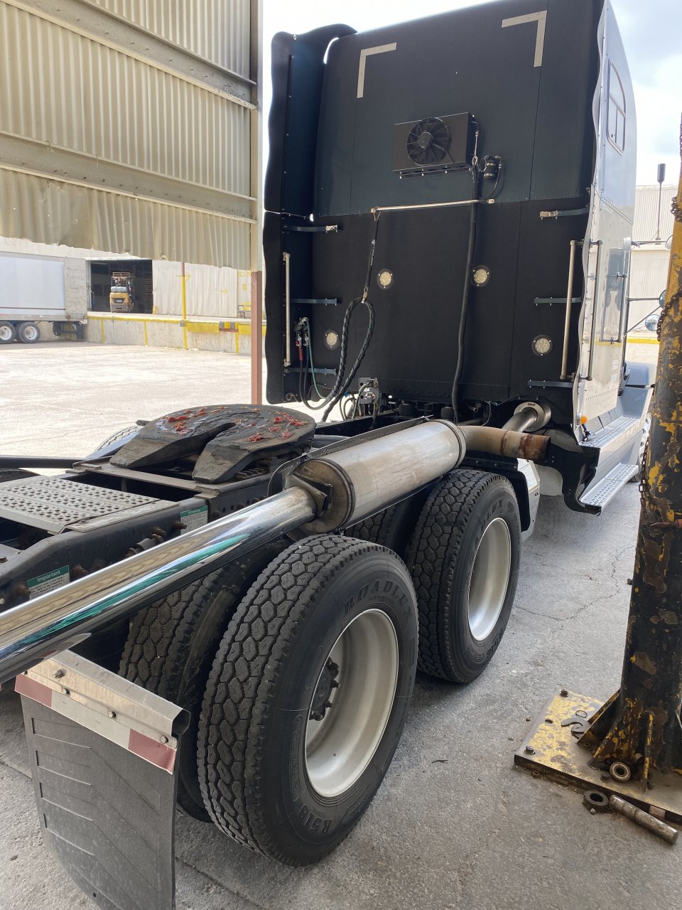

    So, just updating; get ready for some backyard welding, and feel free to point out something if it’s structurally foul.
    I originally just wanted to mount my catwalk, but I have a 3 door headache cabinet for when I grow up and run open deck. So the the challenge turned to also being able to lay the support arms for the rack on the frame and slide the u-bolts down the frame. So now I had to also space the APU and the toolbox away from the frame since I don’t have a lot of wheelbase/real estate to just slide things back.
    First, we had to remove the stack and make some sort of weed burner setup. I didn’t want to run open pipes and have loud jakes, so I bought a shorty muffler (it’s only about a foot long)….I shoulda saved that $80. I knew better. I’ll have to figure out how to quiet her down later.
    We ended dropping the APU about 3”, so lost that much clearance. Then we used the bolt holes in the frame for one side of the APU, and drilled a hole for the other side. We took the original C mounts, and welded them together so I could reach the mounting slots on the bottom part of the APU wall. So that’s how we solved the APU mounting issue.
    The toolbox/step is bolted to the bottom of the basic angle iron brackets with 2 pieces of flat iron welded across the back in order to bolt the bracket to the frame. It is holding up to my weight fine, but I’ll keep an eye on it and bolt the back of the box to the support piece if I notice it needs it. All that was flush to the frame. So all we did was get some 1” nuts for spacers, and took an old freightliner hood hinge bracket thingy (whatever it’s called) and cut it up and welded it to the bracket to run along the frame for support.
    Now I can put my headache rack on when I’m ready.
