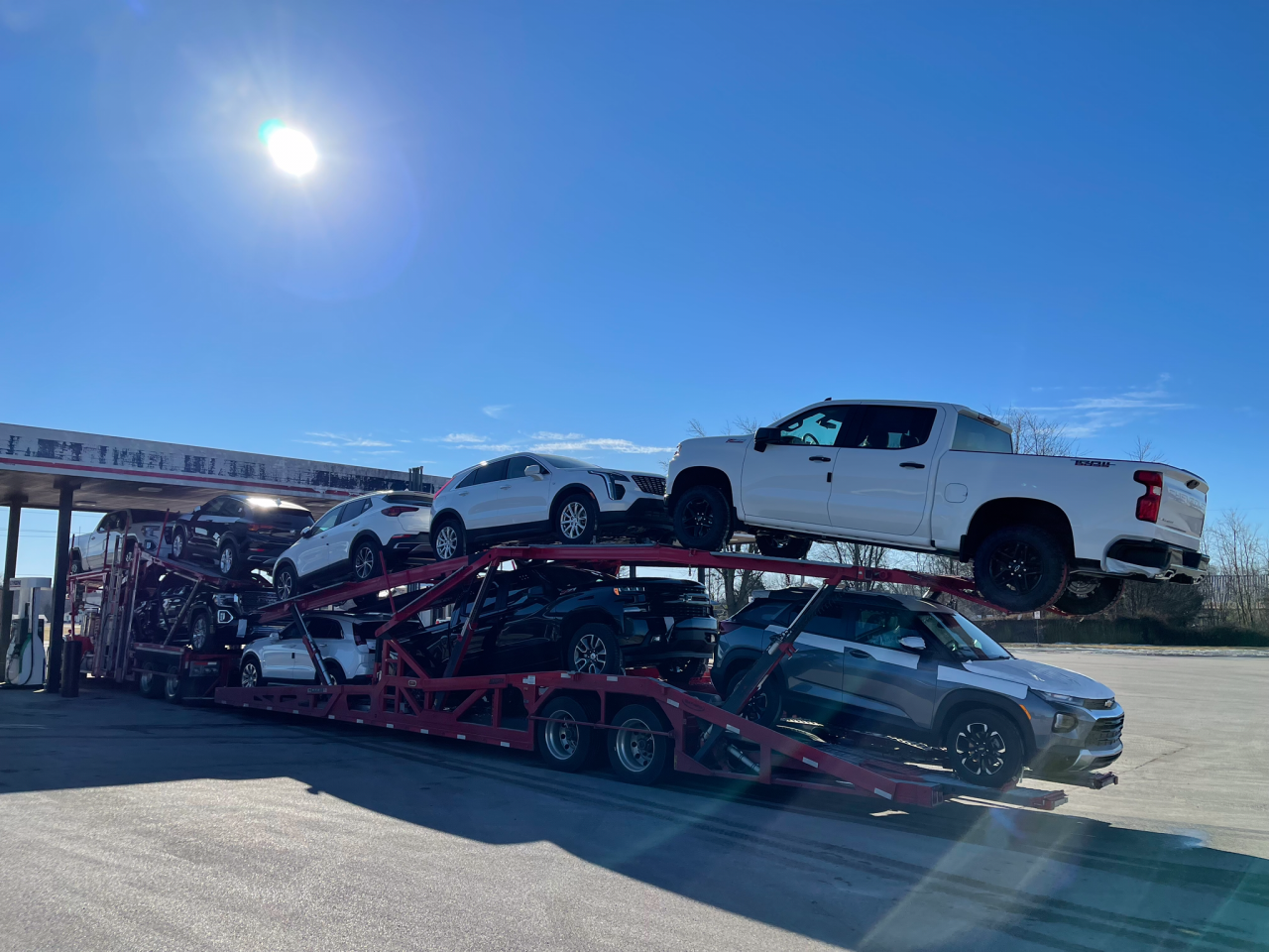

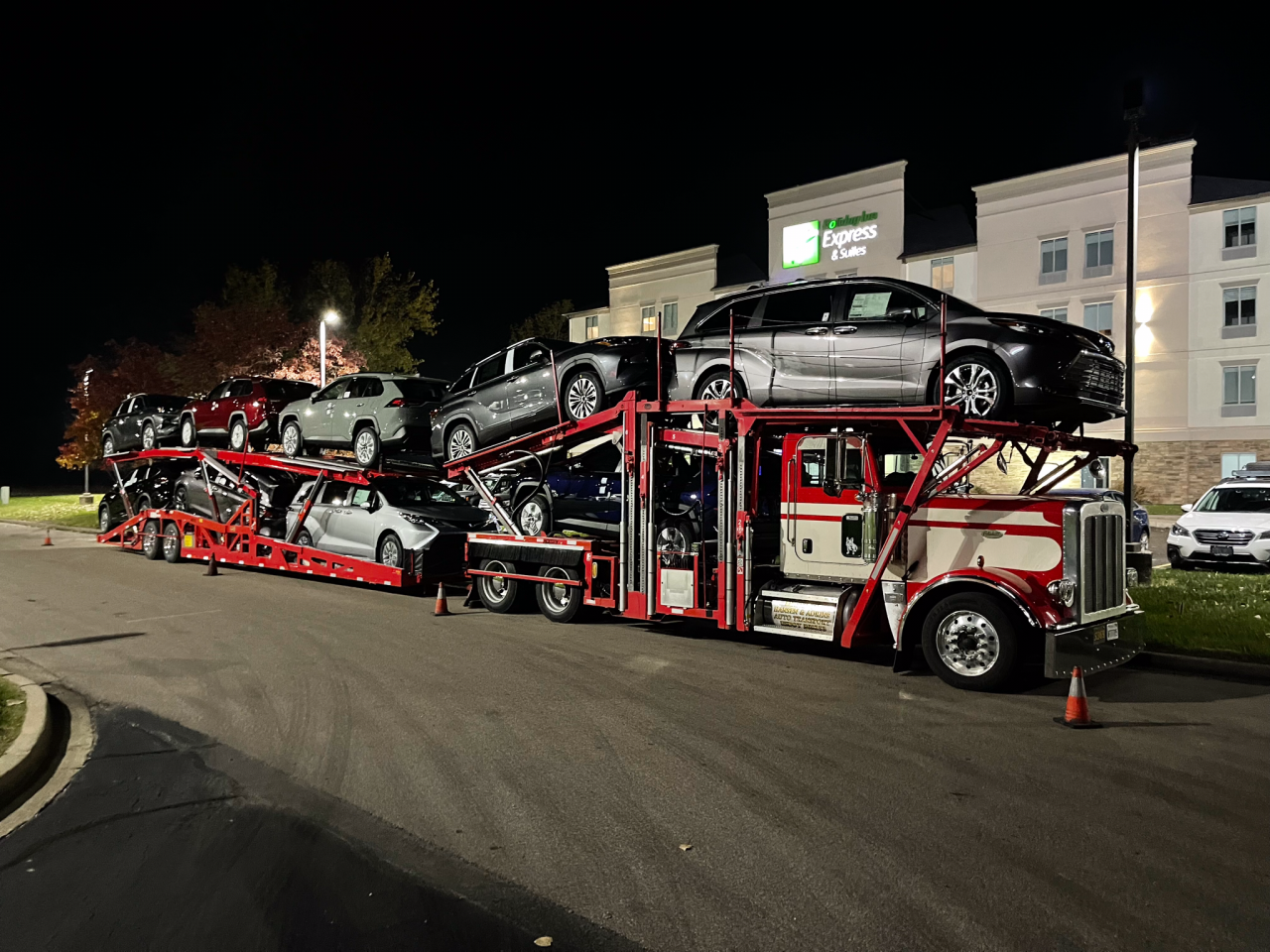

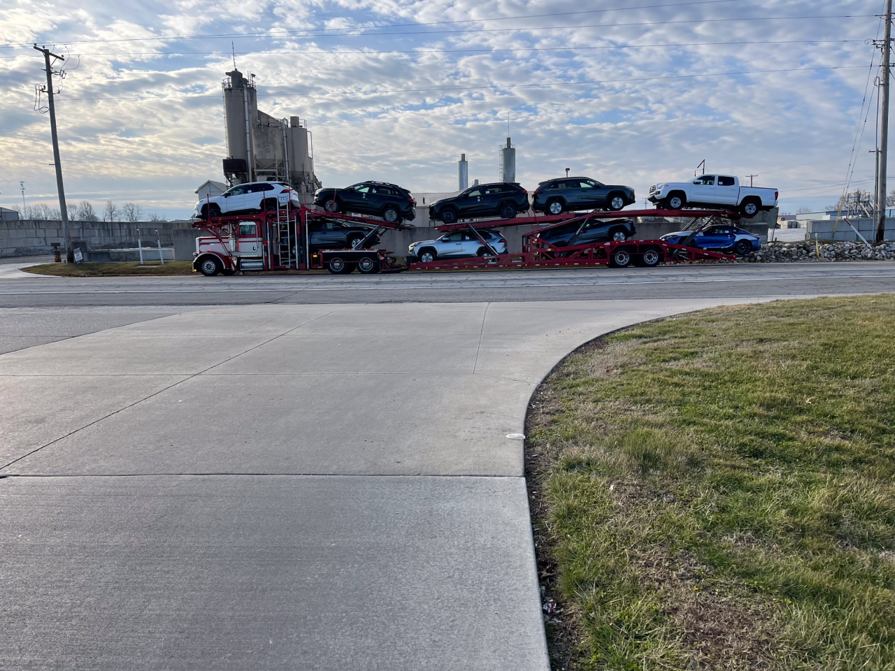

    If it is a one stop load and an 80’ rig the easiest spot for me to put a pickup is on the back top. If I have more than one pickup or it goes to the last stop the next one goes on number 1. If I have a small suv or sedan and a third pickup it goes behind the cab or on the hump of the trailer with a small suv or sedan over it. With 80’ you can put a midsized SUV driven in the belly with a 1500 backed on the hump and a sedan or small suv over top of the pickup and be 13’6. I do my best to load as close as possible as I did the last load I hauled. This cuts down on moving straps and saves time. Sometimes it isn’t possible if you have multiple stops. If I have multiple stops I do my best not to do reloads unless I absolutely need to. With 80’ none of these loads is close to the next unit. 9912DE8B-3F8B-4CF0-BD3D-FBE6386BF6FE.png 7A0DCCA8-16E1-447C-A5C1-23D132536EB5.png 842F7B77-B5AB-474E-B3D4-9BFC20A752F8.png

    Unless I have a really small load I always lay the load out on paper before I load it. I also take a picture of any load that is reasonably large and look at it later on my iPad. You would be surprised how many times I figure a different way to load it that would have either been easier to load, lower or shorter. In most cases with a sedan or midsize suv over midsize suv you aren’t going to be close to 13’6. Don’t try to get it as low as possible because you will tear something up and there will have been absolutely no reason to get it that low or that close. When you have a pickup over a large suv then you may be more concerned, but not if you load it in the best spot on the truck and either drive or back it on correctly.

    OK I see what you're saying good visuals too thanks !
