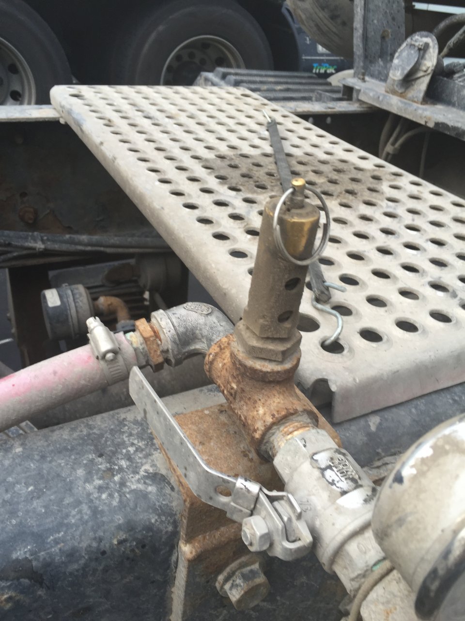

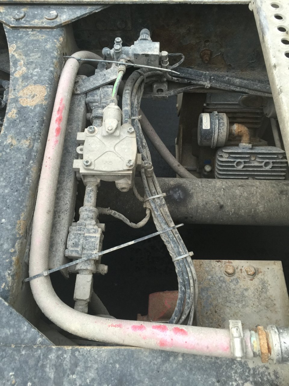

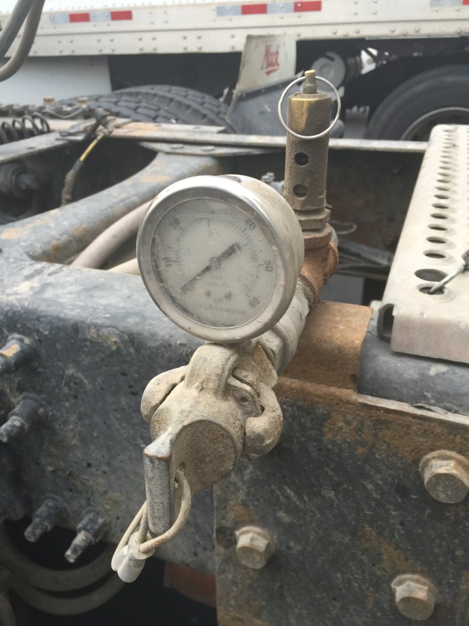

    Here's my setup. The relief valve is set for 30 psi, but I occasionally run a bungee over it to get 40-45 psi when I need it. I haul mainly ISO tanks that can handle higher pressure, but even running 1000 rpm's, I only get to 22-24 on domestics.
