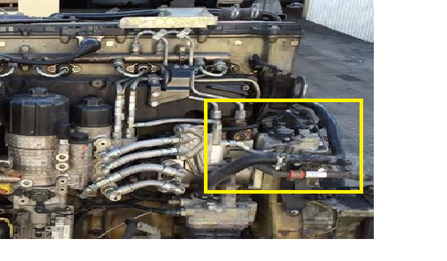

    As pointed out by mhyn this code points to the Hydro carbon HC doser block going bad. This is an expensive little unit to buy and on the tough side to replace as it sits towards the rear of the engine on the driver side.
    The HC doser block is a metering unit that sends diesel to an injector that sits after the turbo on the exhaust side of the engine. Diesel injected into the exhaust flow is what enables the temperature of the exhaust gas going into the aftertreatment box to go up for a regen to happen.

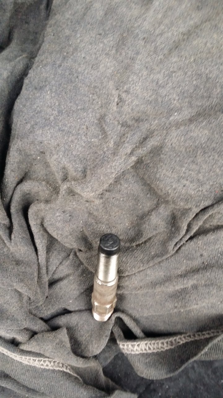

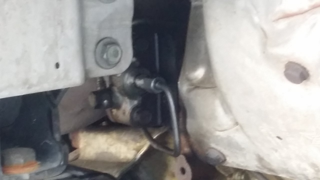

    1st and easiest to do is to check your DOC inlet temperature sensors for proper resistance values as per the guide mhyn posted above to see if you have faulty temperature sensors. If these check out ok and you have access to detroit computer software, remove the HC (diesel) injector shown below and clean it. Be sure to look inside the hole where the injector sits. Poke around and clean the inside of this area of carbon build up that tends to build up and block injected diesel from reaching the exhaust gases and being carried away to the aftertreatment box hence preventing the temperature from rising, stopping a regen from happening. Code 061 spn 3713 31 poped up for me indictaing that a regen had been aborted due to temp not going up past a certain threshold within a specified time.
    After reinstalling and reconnecting the fuel line, perform a purge HC doser under service routines to purge the air out of the injector line and perform a regen. If sucessful your issue should be fixed if, if not and the code still persists then the doser block is faulty will have to be replaced.
