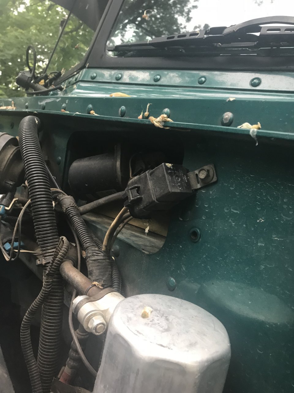

    AEC5EDB3-2BFF-4B9A-B376-BDC758F4C1BA.jpeg 768D48F7-A529-48A2-A690-4486F7824199.jpeg mine is not mounted on the firewall. Unless the thing I have pictured is the relay. I don’t know. Got a click today but no start even with my new starter I installed. Heard a click somewhere. Hit the ignition again and it started. It was my issue before I put on new starter. Weird nonsense isn’t it? Yes I cleaned and wire brushed all the cables before putting on the new starter. Did not buy a cheap unit and it is a 39mt paccar starter. Thank you

    Yup, starter relay. Check connections at the back of the ignition switch too. SURELY you've been through all the batteries and connections right?

    So that is the relay on firewall? Should I put a new one on? Put 3 brand new batteries in and cleaned and put anticorrison on all the leads

    Relay is cheap, so yes. If you dont have the means to diag it while its acting up or cant catch it, a new relay is always a good idea as the contacts dont last forever. Same with the ignition switch.

    My relay doesn’t look like that. But mine is a 94.

    That’s why I was confused. I have seen your type and it had me boggled
