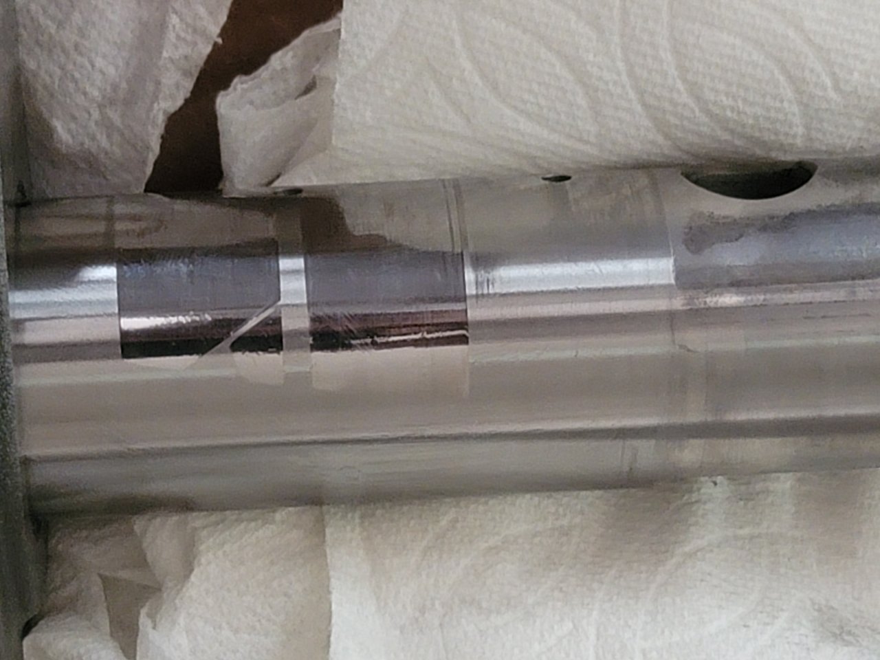

    Why would you buy a used one, especially since you are looking for longevity? Somethings you can buy used, a used truck, used tire, but NEVER a used internal engine component. Replace it with a new Cat OEM.

  3. Sixamskier
    Sixamskier Bobtail Member
    Joined:
    May 15, 2021
    Messages:
    12
    Thanks Received:
    5
    Location:
    Pocatello, Idaho
    Yeah, I agree. I was under the impression that it would need replaced at overhaul anyways, so I figured I'd throw a used one in there until overhaul time. But it sounds like they don't replace the head components if they are still in good shape. I figured it would be wasted money going with new if it needed replaced again someday soon. The ecm shows 800,000 plus, so I'm hoping to get to the 1,000,000 mark. But maybe that's wishful thinking?!? I'm half tempted to pull the head and do an inframe while I've got it torn apart.

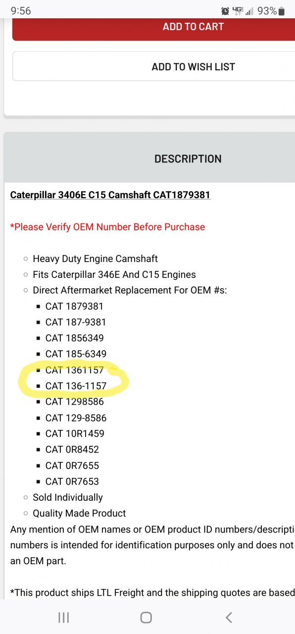

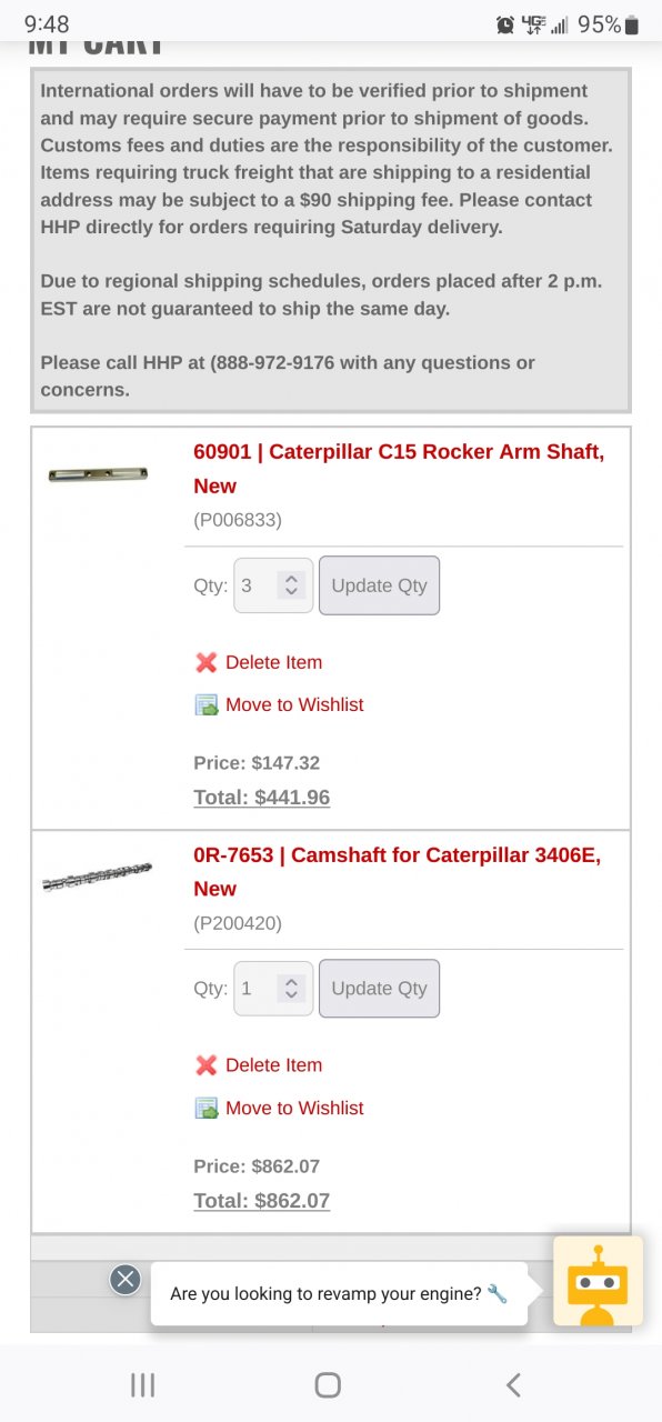

    Is atldiesel.com a trusted supplier? Also is the 0R7653 from cat a reman? Or does that just mean they require my core back?

    6,512
    Cat pretty much wants cores on everything to limit the competition. They probably through stuff like rocker arms in the trash. That Cat cam is probably new but from where, China?
