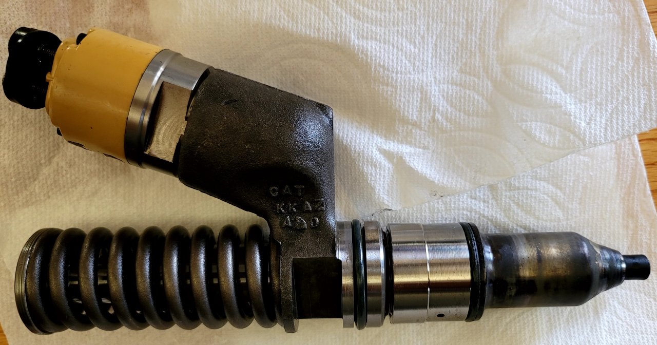

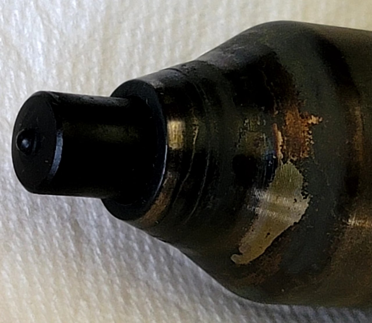

    Clean the tip of the injector with a brush BUT, DONT NOT TOUCH THE ORIFICES ON THE BOTTOM OF THE TIP WHERE THE FUEL COMES OUT. At least that’s what my Cat guy told me when I was cleaning mine to install the new o-ring.

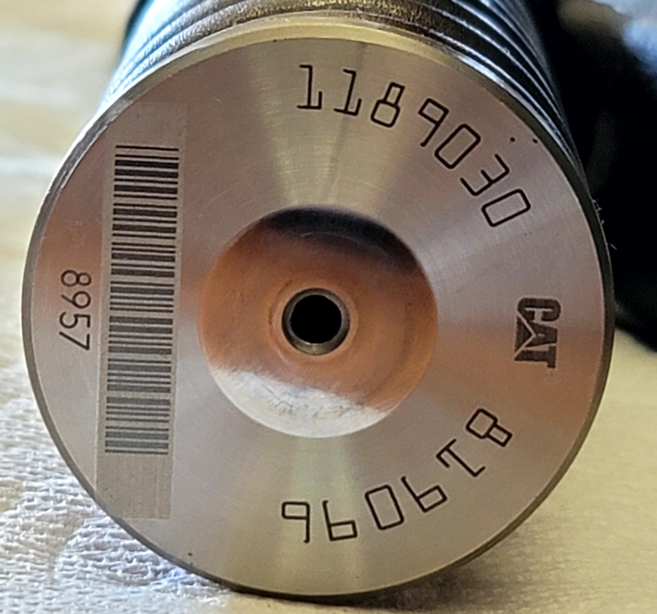

    On Injectors, you are correct they are "57's" and the 118-9030 is an original injector. When I pull the injectors out of motor, after quick visual inspection they go directly into a gallon freezer bag. Visual inspection of yours reveals issues with cylinder head. You have combustion gas past tapered seat. Another rabbit hole, but basically I'd suggest closer inspection of injector and probably injector seats need cut at minimum. Least amount of handling is best on injector, doesn't take much to destroy one. Latest thing cleaning is just to clean the tip only in ultrasonic cleaner, I haven't made a basket to do this yet so can't give you any feedback.
    Your engine is a 435 from a Volvo. Is that still the case? What is your plans? Will need iron to make a 550, like cylinder packs, turbo, and others. I have that file at home and can reference for you if needed.
    Your cam is the same as a 550HP 5EK/6TS. Injector lift is actually more than the 139-0537 one used in the 6NZ C-15, but not sure on ramp rates, lobe separation angle, etc. Attached chart.
