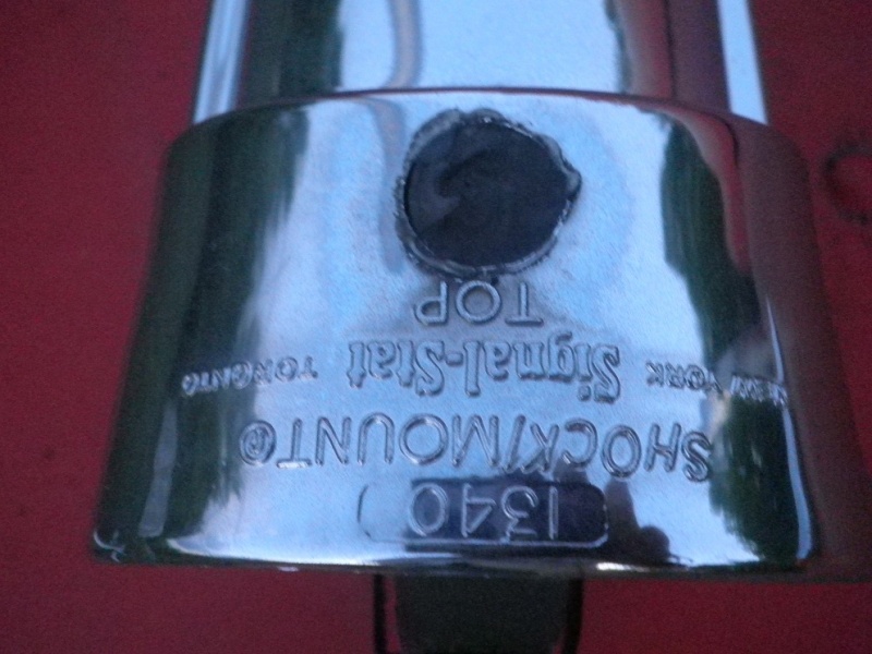

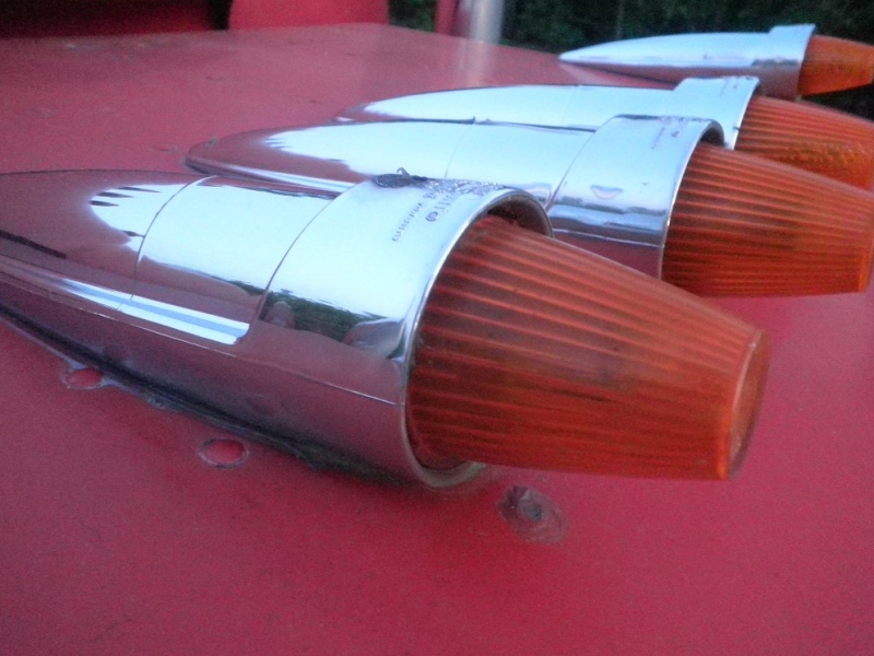

    I need a good Freightliner parts guy or a FLD classic owner to give me a VIN I can work with that has these cab lights.
    Seems like they don't stock the lenses anymore. Part is GRAKON 1000. Says right on the lens. Internet searches turn up these Asian Pacific LED ones that look similar but actually have two screws that hold in the lens. Mine are the twist in kind with three tabs.
    I bought a few spares some years ago from Freightliner but they ain't coming up with a part now. I got these from a Junkyard 1995 FLD so my VIN won't help. Signal Stat is defunct. Part cross numbers show different lenses like ones that came on Macks.
    I need to find 10 lenses or maybe ore if they quit making these things.

    76kdub they are Grakon. The whole light is 1000. I assume it's the same thing the chrome shops are selling as the same number. LED inside and two screw lens instead of twist on lens and they are over $20 each.
    The twist on lens for the old Signal Stat type is Grakon GNI1003T or just 1003T and are around $8 each.
    I bought a bunch of Maxxima 2-1/2 Beehive LEDs for around $6 ea and put them inside mine after gutting the inside of the chrome part and wiring in a pigtail. Now mine are 19 LED and look a whole lot better. Got before/after pics to post later.
