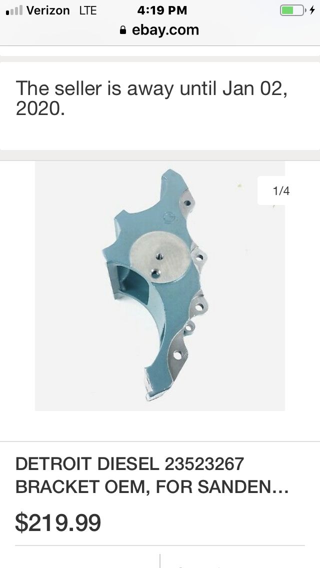

    Update, here’s the actual bracket needed. I’m upgrading my homemade conversion. Getting the correct bracket. Anyone knowing the part # for correct 6 rib serpentine belt, please post it. Freightliner, 12.7, pad mount alternator and pad mount Sandens compressor.

    Update, the correct 8 rib belt is GT4080565, along with the bracket, Sanden compressor. Get rid of that York/TCI junk compressor.

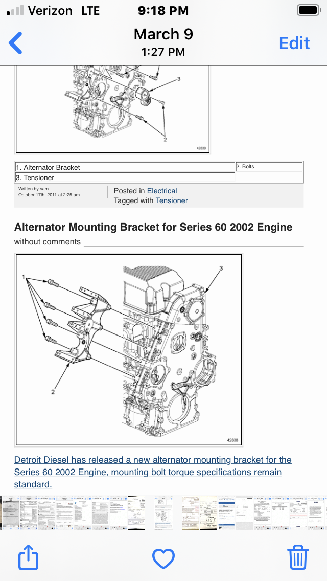

    Will that new bracket direct mount to the cover without modification or will holes need to be drilled in order to install?
    I believe the original bracket looks like this instead. Converting to the serpentine setup instead of the v belt setup would require the new bracket, new accessory pulley, serpentine belt, and new type of alternator, correct? This would be a much better setup than the the vbelt setup.

    F0E54F46-E468-4BC6-9379-C8610AF7BEB5.png I’ve since replaced my front cover, inner and outer. And put the new bracket posted earlier on. However had I known about this bracket. The final upgrade, in 2002. I would have gotten it, along with the upgraded inner front cover, This set up, looks good. Note the 4 extra bolts, going down into the cover

    It will bolt onto the cover. No drilling. They’re all the same. The only one that’s different is the 2002 upgrade I posted, Looks like only inner cover and bracket is different. I really wish I had that set up. Just a matter of time, till new cover gets wallowed out, and bolts start breaking. Time will tell.
