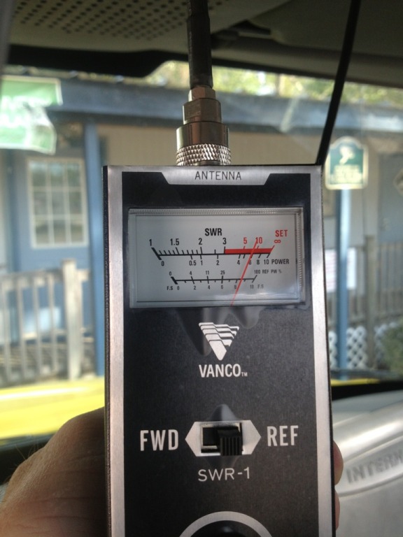

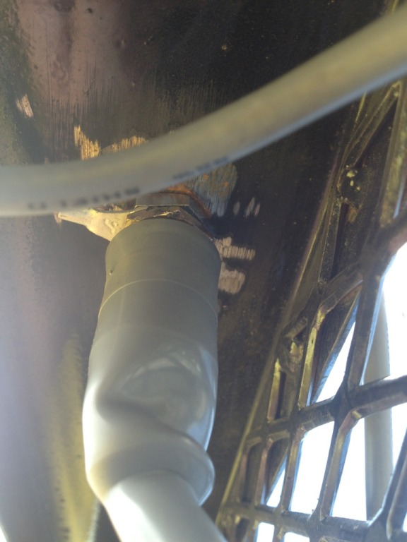

  11. Sodman
    Sodman Bobtail Member
    28
    Sep 12, 2009
    South, LA
    Thanks guys... Pics below, hopefully you can see them.
    1. Meter has to be calibrated. I calibrate it on FWD, and then read it on REF.
    2. There is a difference between ch 1 and ch 40. 1 is usually around 4, and 40 is about 8.
    3. I really don't think the brass ring is touching inside the hole. I've looked at that closely.
    4. I tried a different coax, same results.
    5. I got rid of the soldered external ground, but then it got worse. I then crimped a connector and attached it to base antenna connector, right below where it touches the truck ground. This wire is the 12 ga stranded wire (bc that's the best I have right now), and it is several feet long... and have it secured to a bolt that goes through the frame rail. (I had drilled that hole a few weeks ago to mount a hose reel.)
    6. I'll try running my hand along the coax. (truck is at shop, I'm home, and it's now storming)
