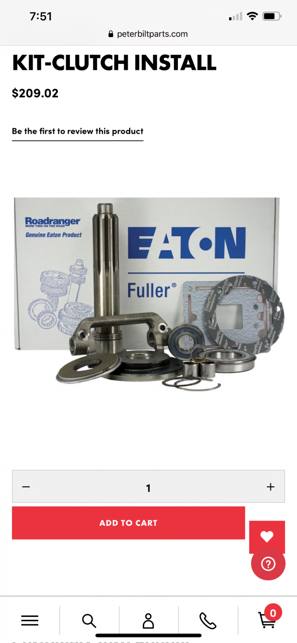

    Yes, new throw out bearing comes installed on clutch assembly. It’s not like a car where you install it with the clutch. It’s part of the unit. It also comes prelubed but also still need to grease it after install. Just saying, even if they didn’t grease it, there is no way for it to have failed already. It’s common practice to install Eaton clutch install kit as well which comes with new input shaft and bearing as well as forks. You had a new trans installed so it should t have needed that. If the cross shaftsbushings were bad, then you just replace those in the bell housing. They are cheap.
    First pic is clutch assembly with throw out bearing on top. Second bearing is Eaton clutch install kit which you shouldn’t have needed. The only reason you would have needed new clutch forks if someone was double clutching that rig all it’s life and wore out the tabs
