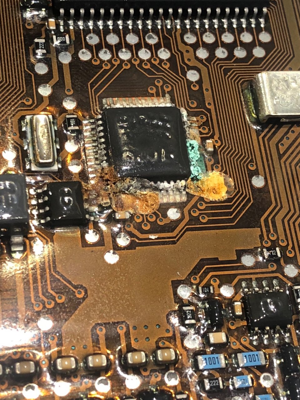

    My DDEC IV ECM fried. Battery leaked inside. (unrepairable) Replaced ECM from Freightliner with software matching serial number. Installed. Truck starting fine. Engine is running fine till coolant temp gets to 130F. Fan is running all the time. Then truck shuts off. Check engine light is flashing until I turn ignition switch off. No Flash code, nothing. No codes at all. Starting fine again and after 5 minutes same problem. Any Idea? Thank You!

    Needs to have proper parameters installed with DDRS program.

    Installed proper parameters by Freightliner dealer. Truck is running fine.
