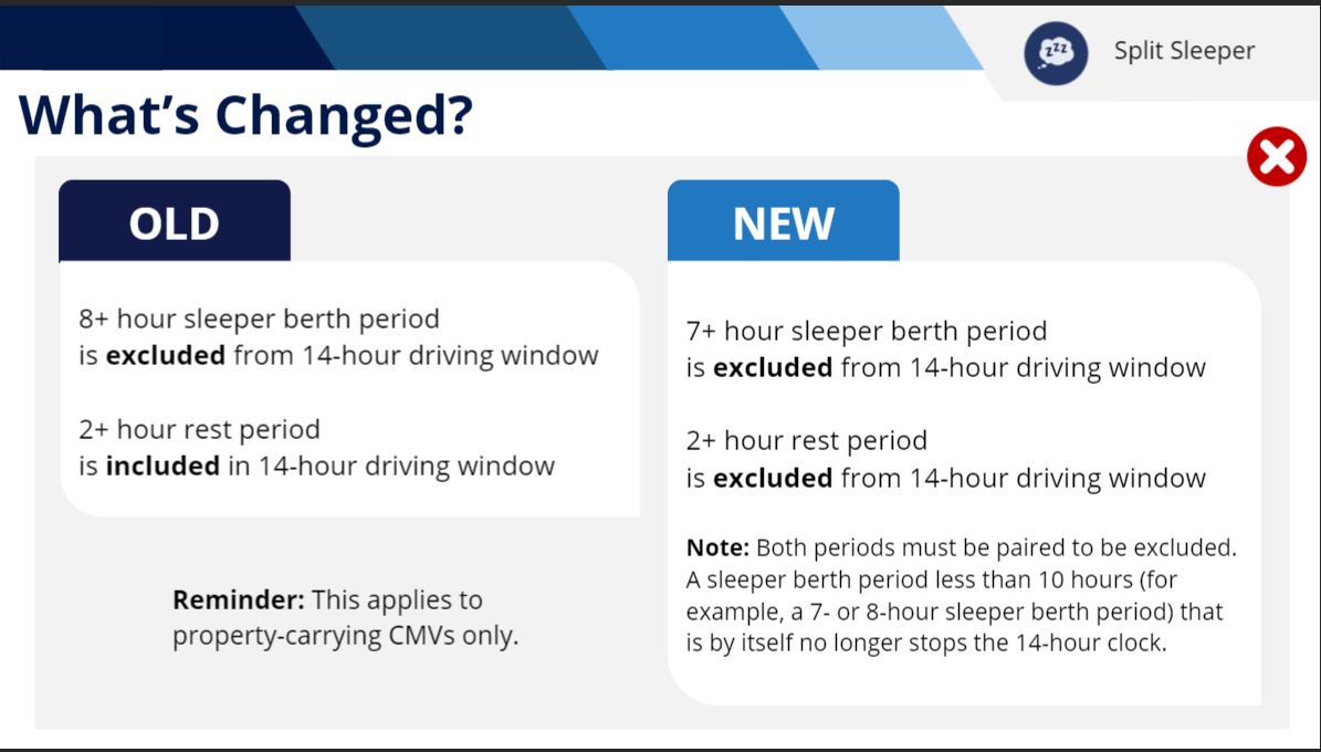

    Hot off the press. Enjoy. Post questions below. Should I do a youtube video discussing?

    I still can't believe that they didn't allow to stop the 14 hour clock for a 2 or 3 hour rest break. It still forces drivers to to drivers to drive tired.

    """the sleeper berth exception to allow a driver to meet the 10-hour minimum off-duty requirement by spending at least 7, rather than at least 8 hours of that period in the berth and a minimum off-duty period of at least 2 hours spent inside or outside of the berth, provided the two periods total at least 10 hours, and that neither qualifying period counts against the 14-hour driving window."""
    Sure would like to know how it "Forces" a driver to drive fatigued... please explain.

    I stand corrected. I didn't realize that you could take a 2 or 3 hour break befor the 7 hour break

    To add, I am more than willing to answer any question but please at least go through the .pdf and website I posted above. It clearly states that qualifying split sleeper periods stop your clock. I'll attach a photo if it better explains what the text does not.
