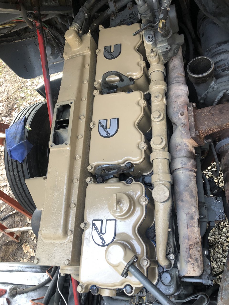

  4. Binderdavemays1
    Binderdavemays1 Light Load Member
    169
    80
    Jul 30, 2024
    Luebbering Mo
    Ok overhead is complete
    Turns out I have a 1984 9670 with a 1979 ntc 350 bc in it, who knew lol.
    No antifreeze or diesel in oil but it only ran 10 minutes with new oil in it.
    Dropping the oil pan to inspect internals
    Now. Anyone tell me if rocker box covers have a torque specification please?
    Also motor still turns over great by starter but not by hand at all no idea why.
