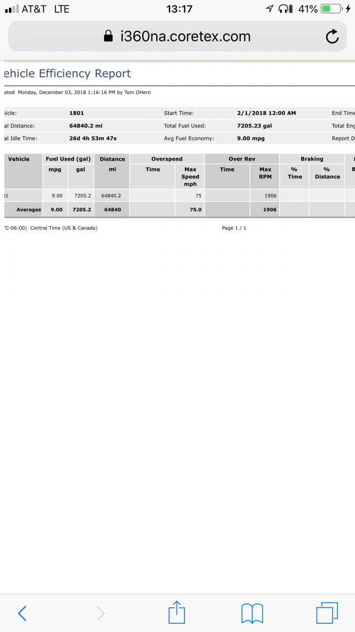

2150 miles between fill up since the over head at 17% deadhead, 8.6 mpg. Filled up in Rudy, AR at the Hilltop on 49. Weights were 78k to Amarillo and Lubbock, 79-80k to Emporia Kansas (this load is where all the empty miles occurred to deadhead to Garden City, KS), then 78k to Salem, MO and Springfield, and now again 78-79k to Effingham where I filled on my way to OH. I’ve been loaded down more than usual and running in Texas is not something I normally do but it’s looking good.

Still doing great. I’ve started resetting the computer every fill up and checking it. Since the overhead, the computer mileage is all over the place. I just filled the day before yesterday on 960 miles from Erie, PAto Meridian, MS 75k and some change gross and got 8.56. I’m usually filling up every 900-1200 miles, depending where I’m going and I’m consistently getting 8.5-8.8. I’ve had a couple low 9s in there under good conditions; just cruising and little traffic. My gross weight stays high around 73k average and my DH miles around 17-18%.
