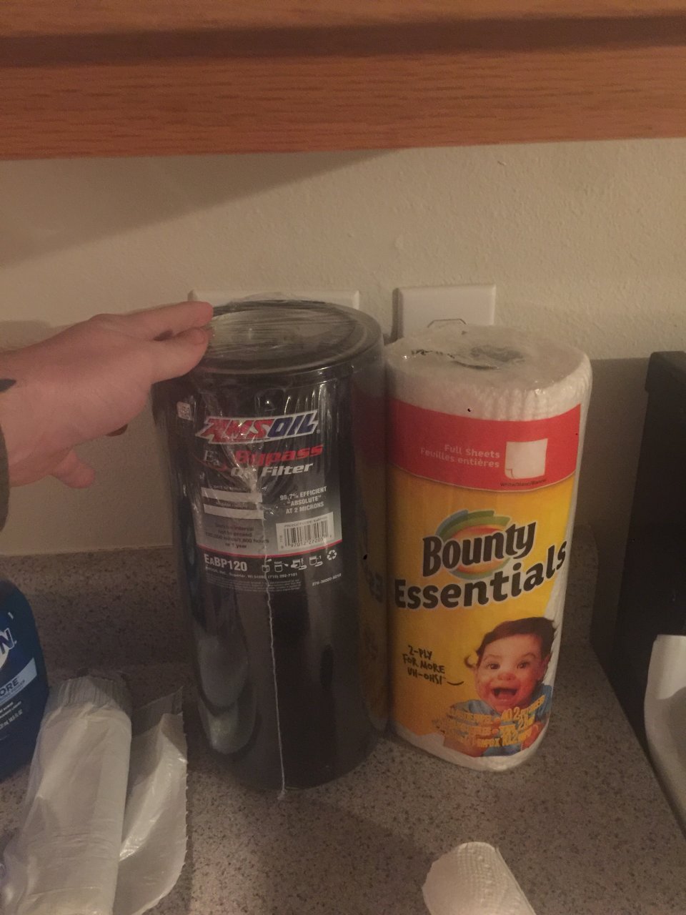

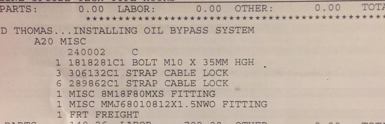

    Bypass filter is complete. If anyone has an A26 and you want the Amsoil Heavy Duty system on it; they ran the supply from a T at the fuel pump and ran the return to a port at the base of the dipstick. The filter is mounted on the batter box behind the driver side front fender. I’ll include the fitting list below, they used Stratoflex fittings.

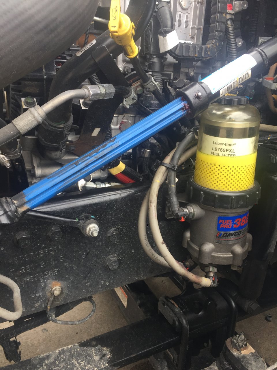

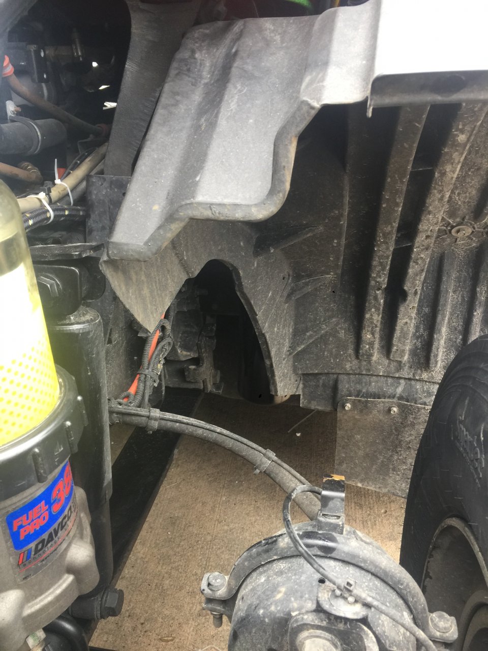

    I’ll get some better ones later. There’s little space under there and it’s hard to get a good picture. Below the red line by the steering column you’ll see the shiny new fitting at the return. And the other pic of the fender well, you’ll see the filter at the bottom.
