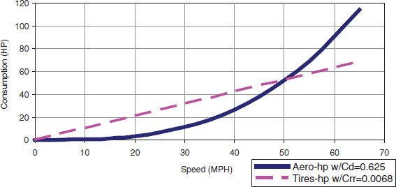

  6. Accidental Trucker
    Accidental Trucker Road Train Member
    3,474
    7,947
    Jun 4, 2015
    You have to be very, very careful with that type of comparison. For example, trucks in Europe are governed at 90KpH (56 MpH). Horse power demand from aerodynamic load plus increased rolling resistance at 65 vs. 65 is substantial. Gearing is different. To draw conclusions about driveability at a certain HP and leave out cruising speed is going to lead to the wrong conclusion. If you look at the graph, at 55 MPH, the HP demand of the combinations is about 125. At 65, that demand jumps to a combined 175, an increase of 50 hp, nearly 1/3rd.
