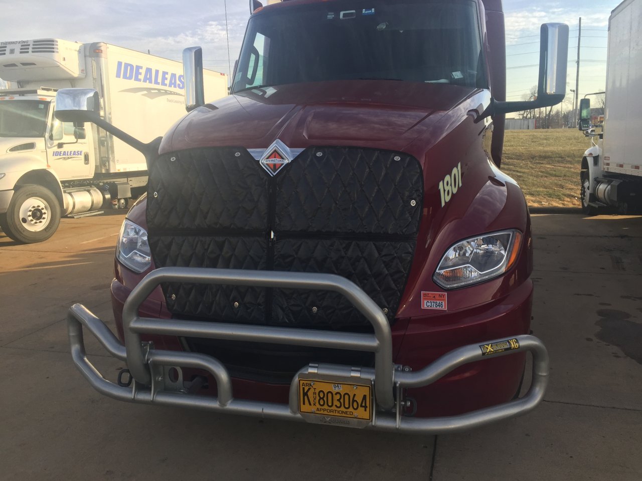

    I have my winter cover and if the high for the day is going to be under 32 degrees, I put it on. It made a huge difference the first winter I had the truck. The A26 cooling package is too large in my opinion. Works great when it’s mild or hot out, but horrible in extreme cold or just cold. I had a code come up that first winter without it regarding EGR flow rate. It only happened once and cleared itself, since using the winter cover I didn’t have an issue.
    In Wisconsin a month or two ago when the Polar Vortex blew through and it was extremely cold, I had it fully closed and the truck came nowhere close to being too hot.
