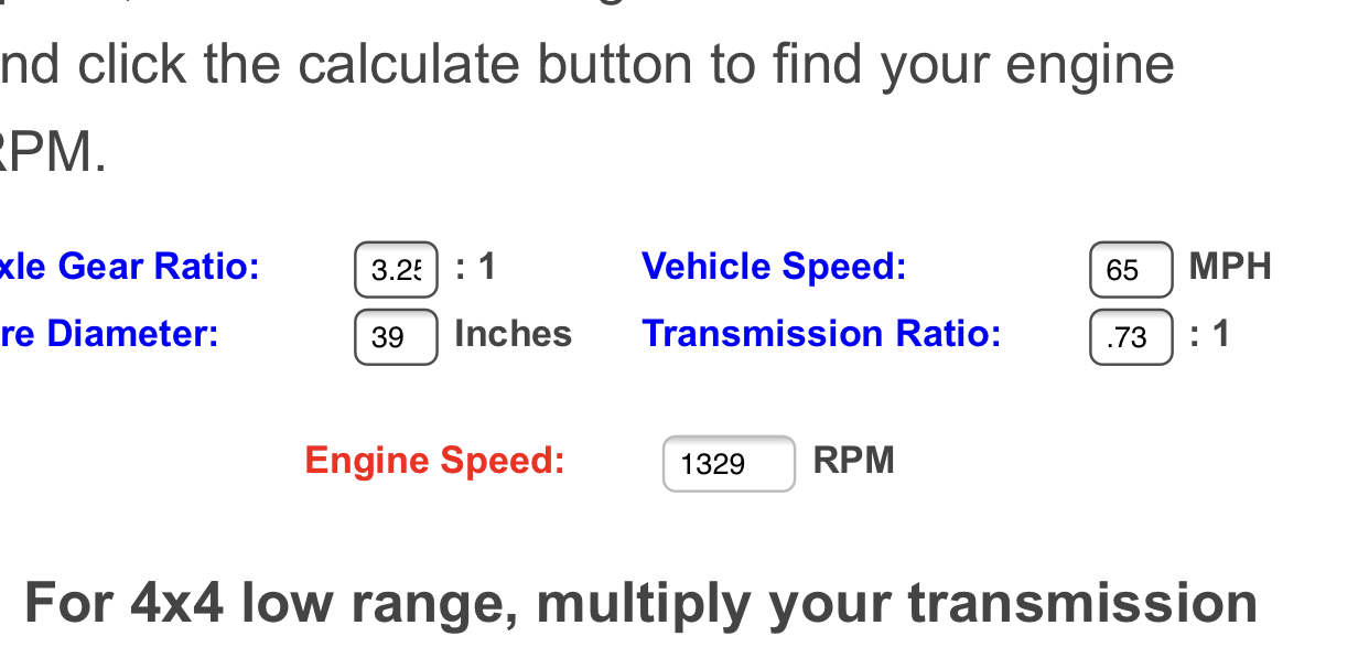

    Thanks, the rpm needs to be down closer to 1200. Will need 3.08 or 2.93.....
