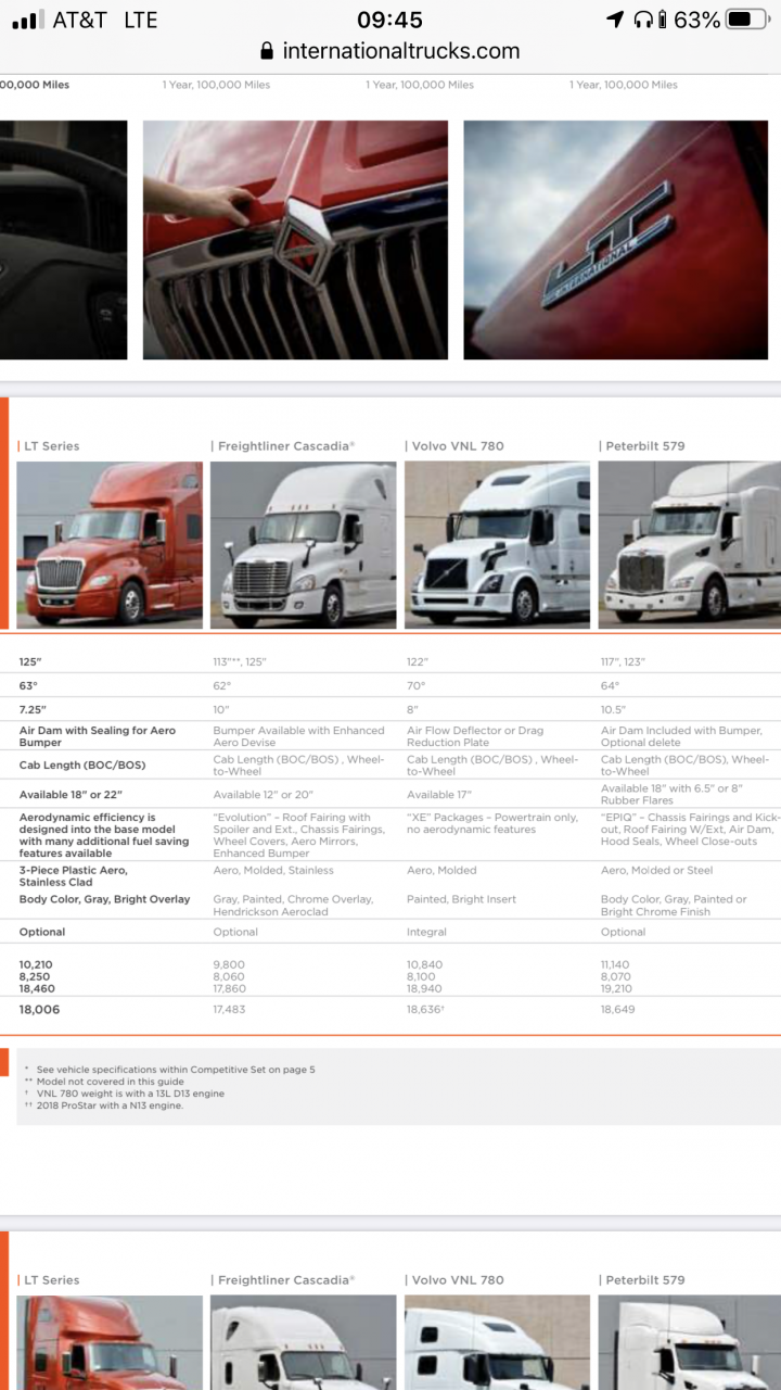

That stamped weight, if correct seems a little high, even with the APU. Was the APU factory installed?
I drove for Groendyke and we had some mid roof T680's with door stamps of 15,875 or something like that. I've seen the mid roof T680's advertised online showing door stamps of 16,090. Kind of makes me think the door stamp is BS. I drove a Cascadia mid roof with DD13 and DT12, with super singles and fixed 5th wheel, but has a pump on it. I weighed it low on fuel, without me in it at 16,800.
I would think your truck is lighter than what the stamp say it is, maybe not. Weight is money. I really like what you're doing and it's going to make even more money as fuel prices rise to $3.00+Misesian Thanks this. -
