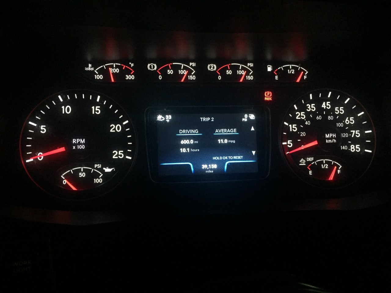

    Yesterday I had Summit do their software upgrade on the A26. Navistar had a laundry list of updates. It was a campaign so they have been bugging me to get it in pretty quick. I haven’t noticed any problems. I can tell already that, whatever they did, is making a big difference. I took a load from Noel, MO, 54k gross, to my current spot near Minneapolis, and got 11 mpg on the run.

    Road speed was what 54mph?

    I cruise at 60 mph.

    11 mpg seems off considering I'm lucky to hit double digits with a 6.7L Powerstroke in an F550.
    Ssgtkevin and Oldironfan Thank this.
