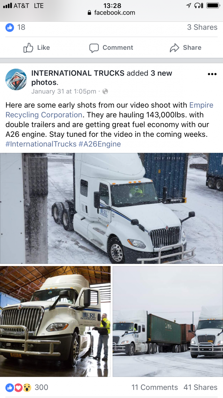

    International posted an article awhile back about a company in NY pulling turnpike doubles, waste haul, in excess of 100k gross.

    I don’t know how to do a link from Facebook but took a screenshot.

    There are no hills on the Thruway - at least not around the lake. That makes a big difference.

    They don’t just pull the thruway. I posted a screenshot of the article. They run in and out of the ports of NJ and back. There is a video on you tube that has more detail. The difference between an A 26 475/1750 Max rating and a 500/1850 from someone else is a small difference. 25 hp and 100 ft lbs. there would be no noticeable difference in everyday operation.
    I only use 200 HP in everyday use. If you are really maxing out the motor everyday to maintain speed, no matter what motor you choose, you’ll never be happy with the MPG. More HP always equals more fuel. If you back off a little you’ll get good mpg.

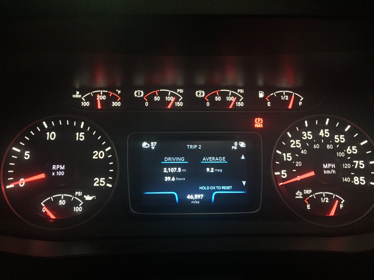

    This is my average on a normal run for me. I had 70K from AR to MD via 40 to 81 nd through DC and Baltimore; loaded in NJ to near Birmingham, 80 miles stop and go through small towns to pickup and get back to the highway, back the same way I came except get on 75 S to 59 S, 65k on this one.
