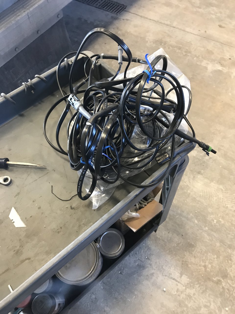

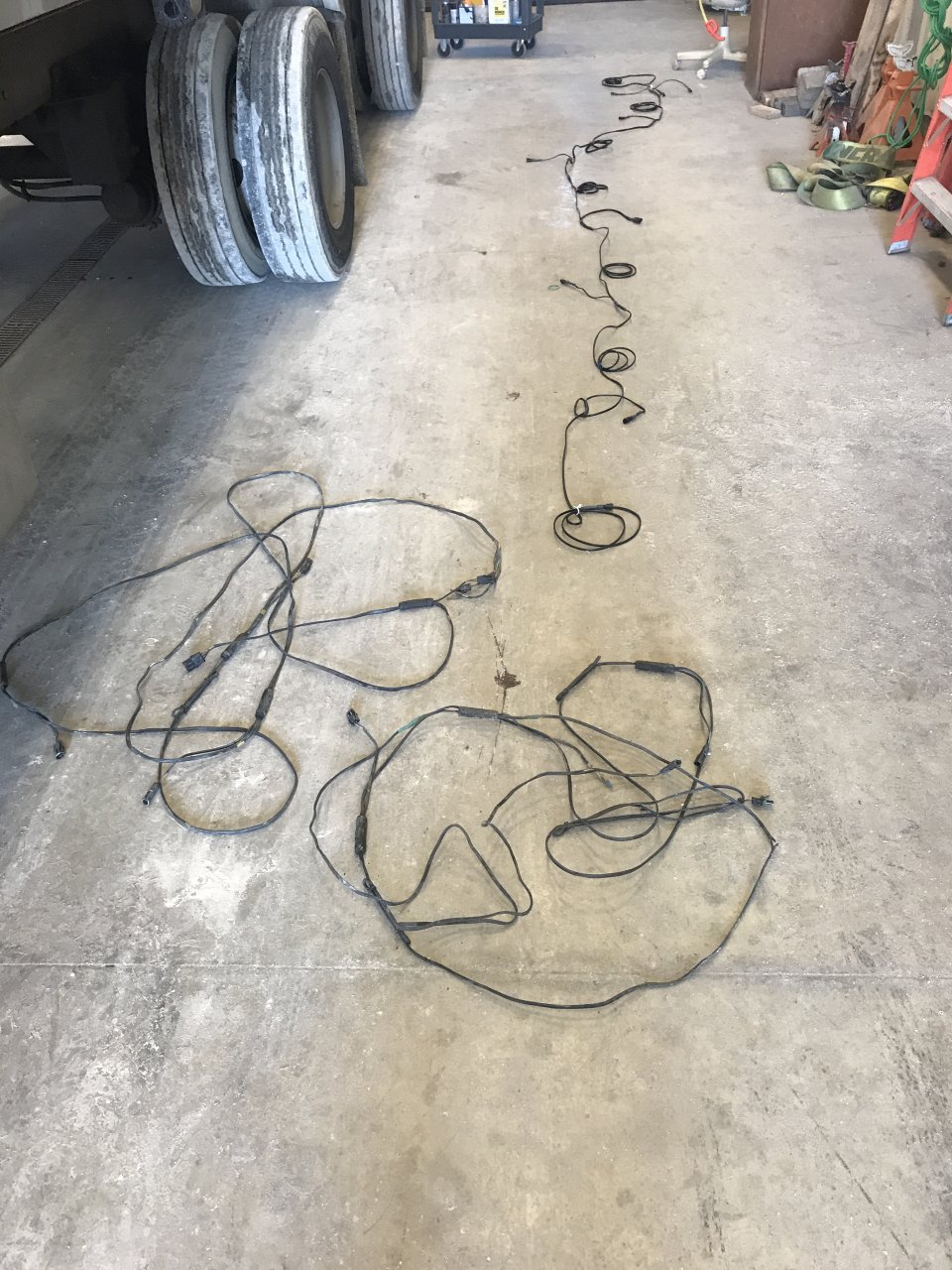

    Where did you get your wiring harness for your trailer lights?
