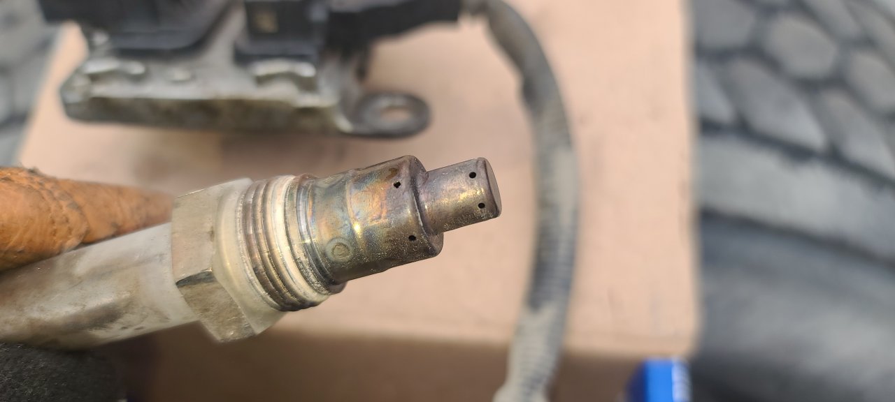

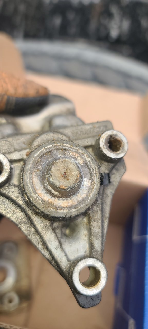

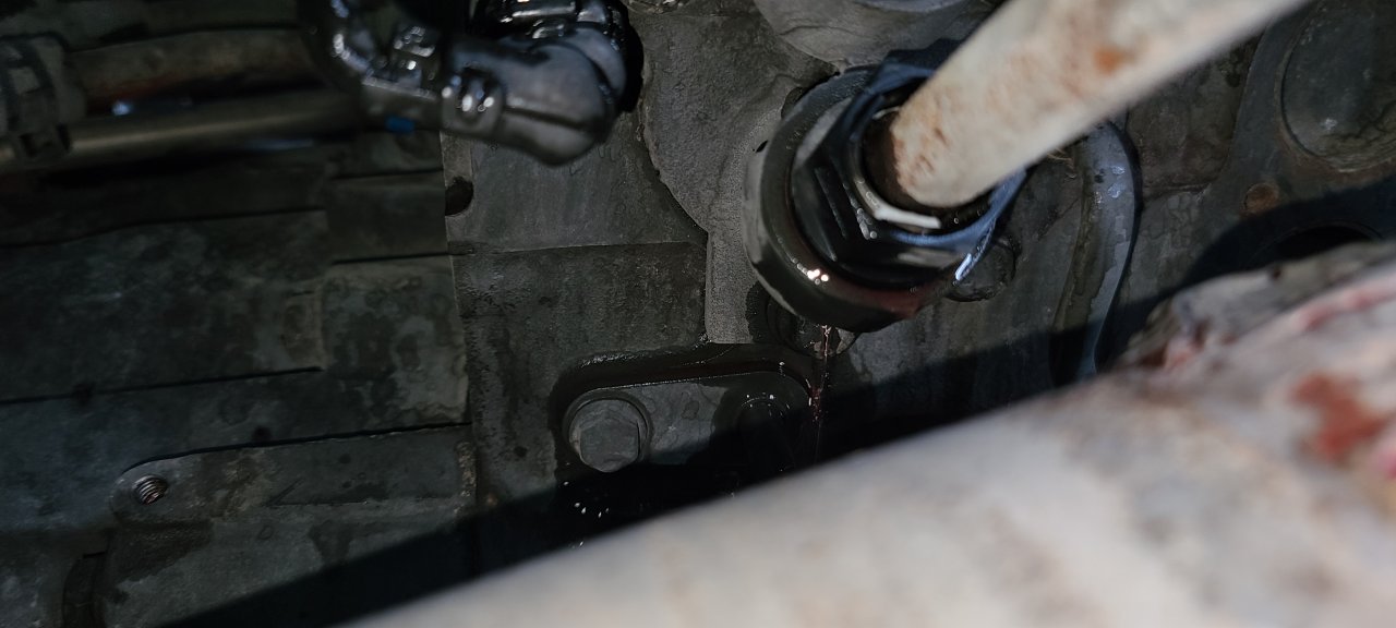

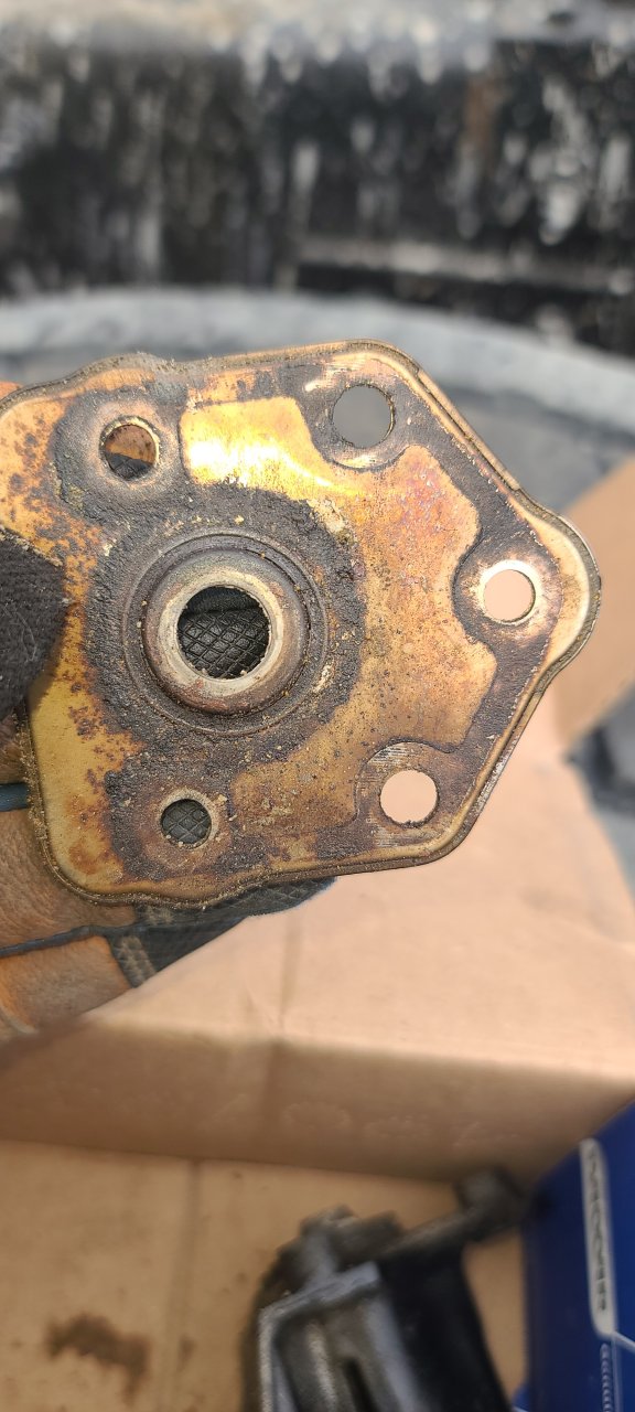

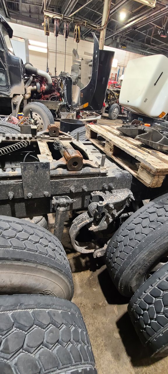

    So another update for anyone who hasnt seen my other posts. Seems going to three diffrent places 2 being dealers and an indy wasnt enough of a pre purchase checkup.
    Truck has been an unmitigated disaster to be frank. Day 1 was the battery incident, then the 5th wheel cracked and LITERALLY fell off the truck with my trailer. Then i had a massive laundry list of failures with my emissions system that i MAY have finally solved, all of which were caused by the fact the truck was NEVER maintained according to the last dealer.
    Also had a ton of coolant fittings and valves fail because they were still factory and were recalled....4 years ago. I have a laundry list of parts that have failed and been replaced due to being factory parts and worn out entirely or bypassed/slipshodly repaired. NONE of the periodic maintaince has EVER been done on this truck evidenced by the literal 2 5 gallon buckets full of soot from the ERG system. so i had to do the full set from the ground up just to find all these bad parts. I have replaced literally HALF the sensors on this truck.
    Wireing harnesses were ALL shot and cobbled together with slipshod repairs some of which someone literally twisted the wires together amd wraped them with tape. So ive been replacing them as money allows. ECM ACM and several other computers have failed so had to have new ones installed. One fusebox had several fuses pinned internally and had to be replaced. Many parts had fresh paint to likely hide damages and deep rust that were missed in the inspection and had to be changed. I.E the shocks were rusted through almost and had been primed and panted over. There is evidence of either odometer tampering or a used engine being swapped in due to mileage not matching what was found in some other dealers systems and being far lower then what they had. Nothing defenitive and may have been caused by bad ECM which when changed updated the odometer by adding 200k miles.....
    Counting tows, late fees on loads, fuel and def wasted from regens and test drives and lost wages i am over 55k into repairs. Parts alone were 37k to date with warranty covering 22k and being used up now. So even if i prove odometer tampering (something my lawyer says is iffy at best due to so many bad parts) and the dealer takes the truck back i would be out too much money to be worth it.
    So yea.....not bankrupt yet but talk about a champion MMA fighter level roundhouse kick to the balls with steel toe boots and about as rough a start as you can get. And ho BOY did i ever end up bent over by buba and used like a 2 penny lot lizzard dropped into a super max on viagra day on this truck. Here are some highlights.

    To be fair to paccar this is less a paccar issue and more a i got sold a junker passed off as a good low mile truck issue. Considering stuff like the 5th wheel fell off, the pinned fuse box, the badly spliced wires, the hidden bad parts like the bad shocks, JB weld repaired cracked exaust manifold and glued airbags, no maintaince....ever, clogged ERGs ect. This would have cost just as much regardless if i got an ISX detroit or volvo engine in this condition.
    And i actully have a davie4 tool to clear codes. Doesnt help much when you get 2 5 gallon buckets of soot out of the ERG, or blow coolant fittings for example.
