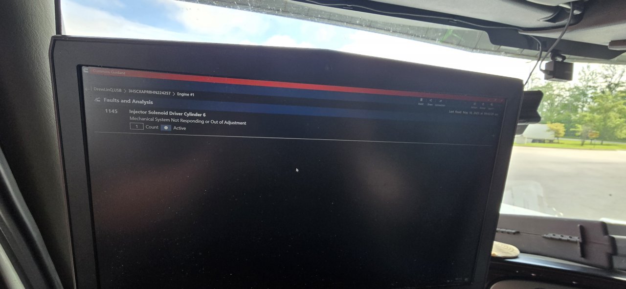

    And still somehow better then my last one.

    Apparently it was just someone forgot to purge air out of the fuel system and it had an air pocket trapped in the lines. Tech said he purged it and the code went inactive. They ran a full injector battery and fuel rail test and it came back green and no electrical faults so....ill take it.
    If the light stays off ill just shrug take the W and move on lol.

    Nope check engine again. I think im finding a diffrent dealer. Rush is proving they earned their #### reputation for being slimey.

    Well its "fixed" again. Wasnt planning to be back to the same shop that did the injectors but they were the only ones who could see me before next thursday. Anyway and apparently at least according to this rush, the guy who worked on my rig was brand new and just out of school. Also apparently my rig is the first one he has worked on on his own....and supposidly he both forgot to purge my fuel lines and also forgot to update the programming on the injector itself.
    So thats "comforting". We will see if the repair takes this time. If so at least its a minor issue. If not im going to have clint route me to nebraska or SD and have a shop i trust work on it.
