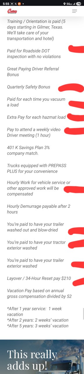

    Custom doesnt hardly do hazmat and then they confirmed half the stuff on their website is a lie 64cpm, 47cpm empty and forced run northeast West coast(Cali, OR, WA), forced ports and Canada
    Only tanker experience counts for experience
    Offered me 66cpm loaded
    They look and sound absolutely awful
