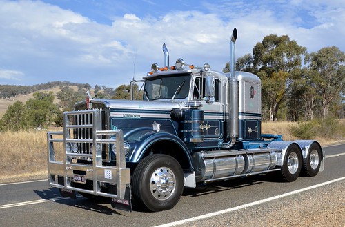

    I'd personally leave It as Era/Period correct as possible..!! They're only ever "original" Once..
    But hey,, Your truck Your Money Do whatever Floats your Boat..
    Have Fun..

    That style guard just doesn't turn my crank - too bulky and square to "flow" with the lines of the truck.
    As for being original, I won't be doing anything that won't easily be reversible. If it had a 5+4 or the like, sure, I would be all for keeping it but really what's the difference between an RTO12513 and an RTLO14913 or even an 8LL?
    Yes, the turbo will be different, but that could easily be changed back if so desired.
    JWAC will be period correct and could have been had on the assembly line.
