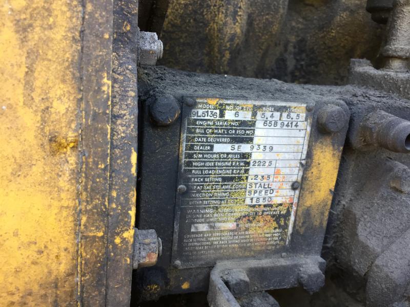

    Parts book said there is supposed to be a serial tag on the front right side of the block - which there is under layers of grease and paint.
    Serial number is 65B4940 and below that it says "POWER UNIT".
    Have a call into Cat to try to get an arrangement number.
