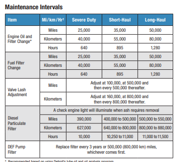

  6. RocketyMan
    RocketyMan Medium Load Member
    549
    336
    Jun 5, 2015
    Woops! Here's the correct info on valve lash:
    100k first and then 500k there after.
