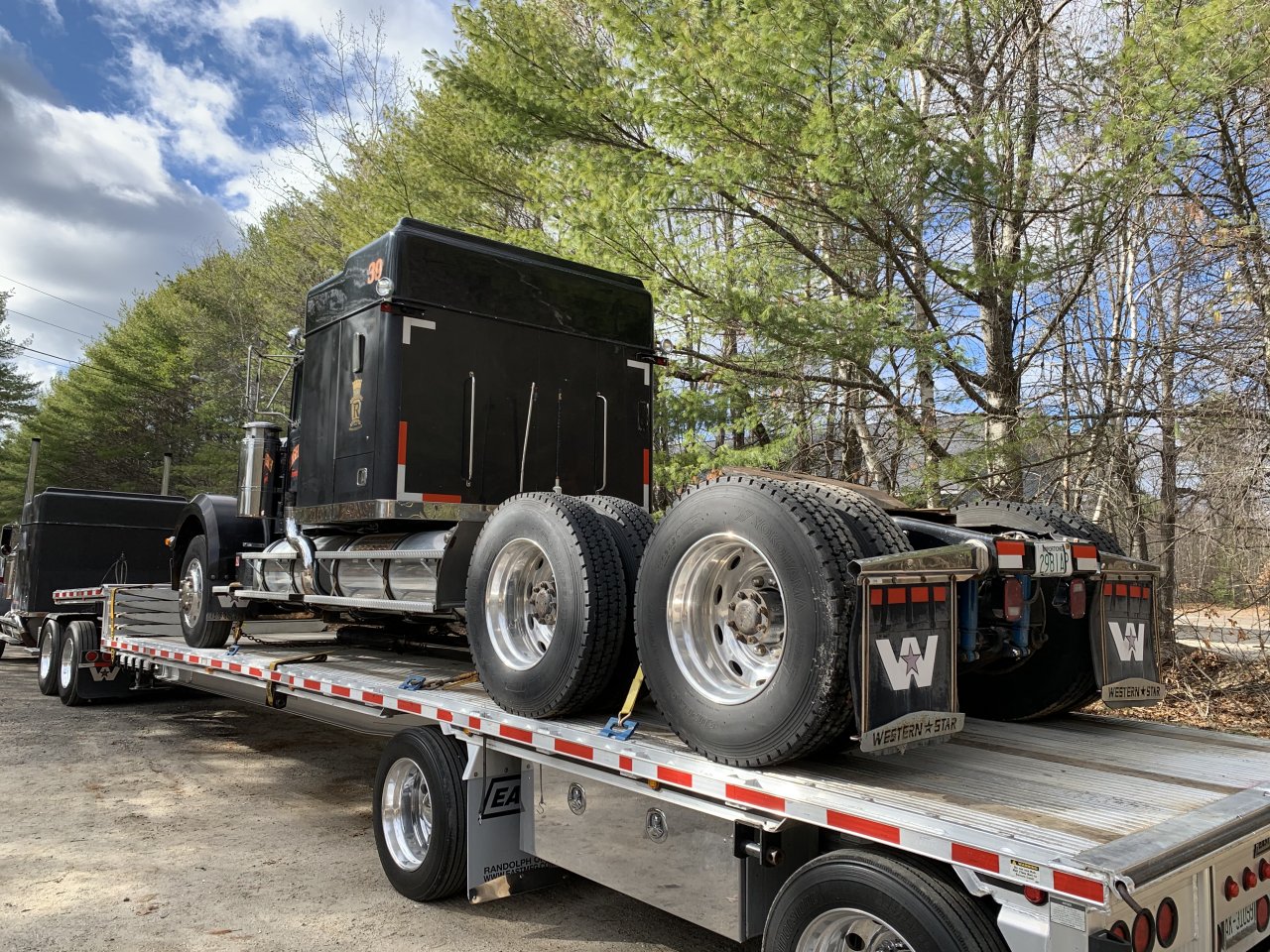

    luckily I dragged a parts truck home with 300,000 original mainly CA miles on it with a mint condition ARD 238! Thanks for replying though
    BigBob410 Thanks this.
  5. PSM379
    PSM379 Heavy Load Member
    901
    3,653
    Apr 19, 2019
    Truck was struck by lightning. The man who bought it out of CA put a lot of love into it. Really sad deal honestly. I plan on using most of the parts besides the Big Cam Cummins.

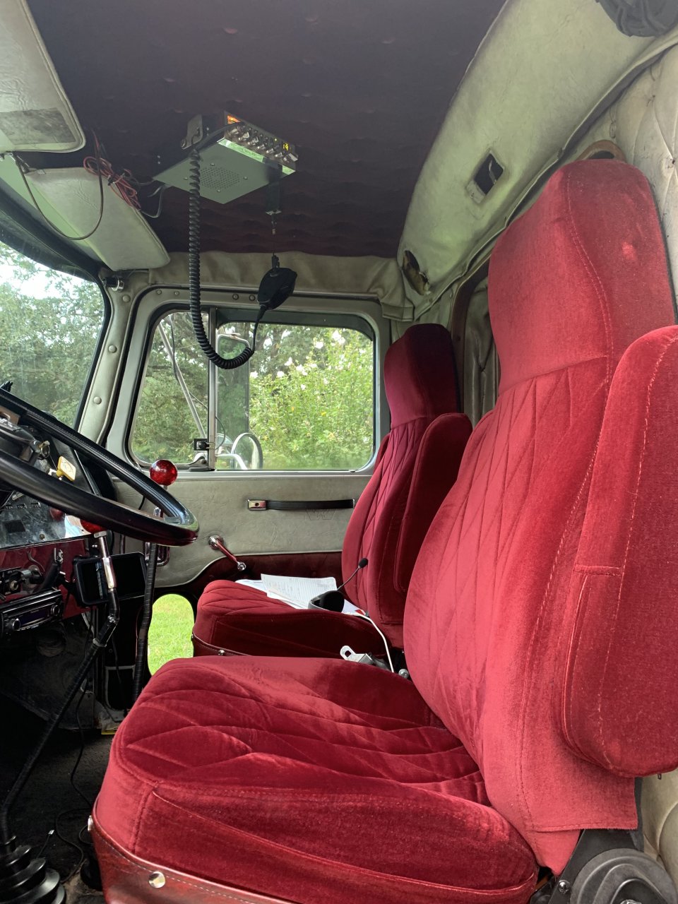

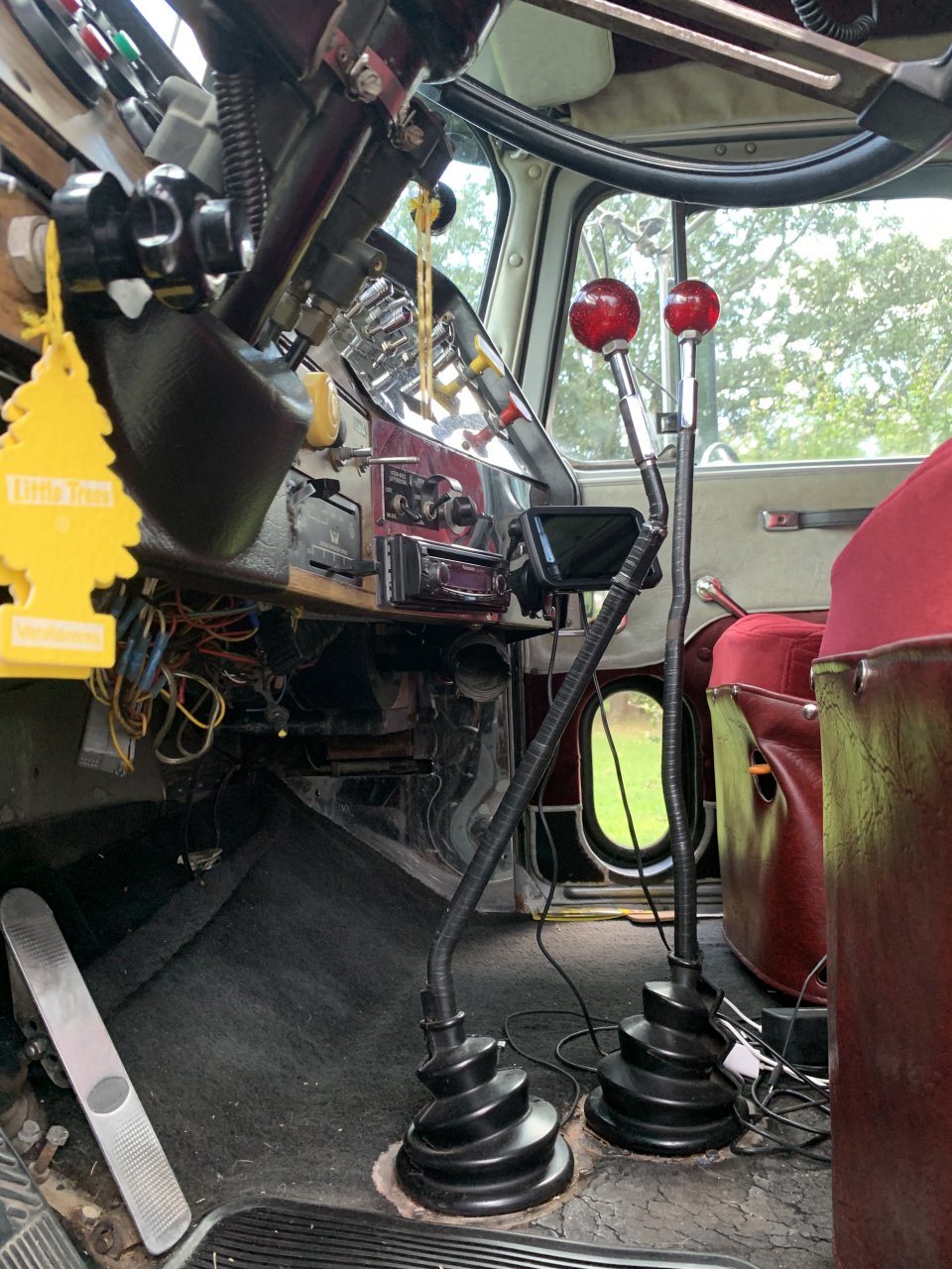

    7597CEEB-BF03-4579-BAA0-8E8869671567.jpeg 30F07CB1-2CDF-4369-BDE0-70F3B883BEB7.jpeg EF9C408F-8262-464C-8EB1-FCF174D6F150.jpeg Interior isn’t terrible, I hate to ditch the factory headliner the hole where the speaker tho is in rough shape. I may have 1 made eventually, and I have new burgundy for the cab and sleeper.

    WOW those are in great shape what year are they? what motor do they have?
