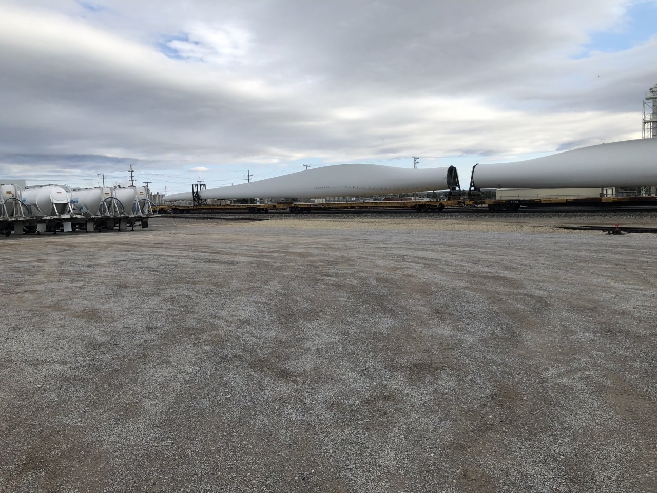

    2A83787C-8335-4D7E-B183-894CC7394BA2.jpeg Thought I posted this already. Just a pic showin perspective of just how big all those windmills are. Looks like fun to haul one of them on the road.
