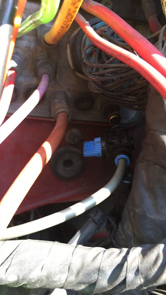

    Okay firstly thank you so much for taking an interest and helping me! My dad bought a generator and a second compressor to build up enough air to finally find air leaks! So he has tried to repair this line but he has no idea what it is. He says everyone is okay for 5 minutes and then this hose keeps leaking for 5 minutes like a vicious cycle. He has attached some valves on there but he is asking if anyone knows what this line is responsible for? So here are the photos...Picture 2 and Picture 4 are of the line (you can see they have a blue valve attached it to) on the inside of the cab between the steering wheel and the door near the foot pedals. Photo 1 and 3 are on the outside view near the steering column and windshield washer reservoir. By the time I try to find him someone specs online I'm sure it will be next month so just curious if anyone knows what this line is responsible for. PS. All your suggestions have been taken into account and he has confirmed that they are all are new, and in good repair!

    That small 1/4 inch black line with the shut off valve with a blue knob looks like it goes under the floor mat, might be to the drivers seat air bag. Just a guess. If he has a major leak, like can't build up air at all, he wont hear it when the truck is shut off. With the truck running if he builds up some pressure he can use a soapy water solution to look for bubbles. I like using the bubbles solution that are sold in the toy dept. Soap solution is corrosive, the bubbles solution sold in toy stores is safe for kids eyes must be safe to use on truck

    Yes it's line to inside the cab driver seat, passenger seat and air blow gun. Other end of this line connected to the air pressure protection manifold. Located inside the frame rail in area where is battery box. Hard to see and work due to there is almost no room between transmission and frame.
    This line can drain pressure from secondary supply tank but will not prevent air compressor to build up pressure.
