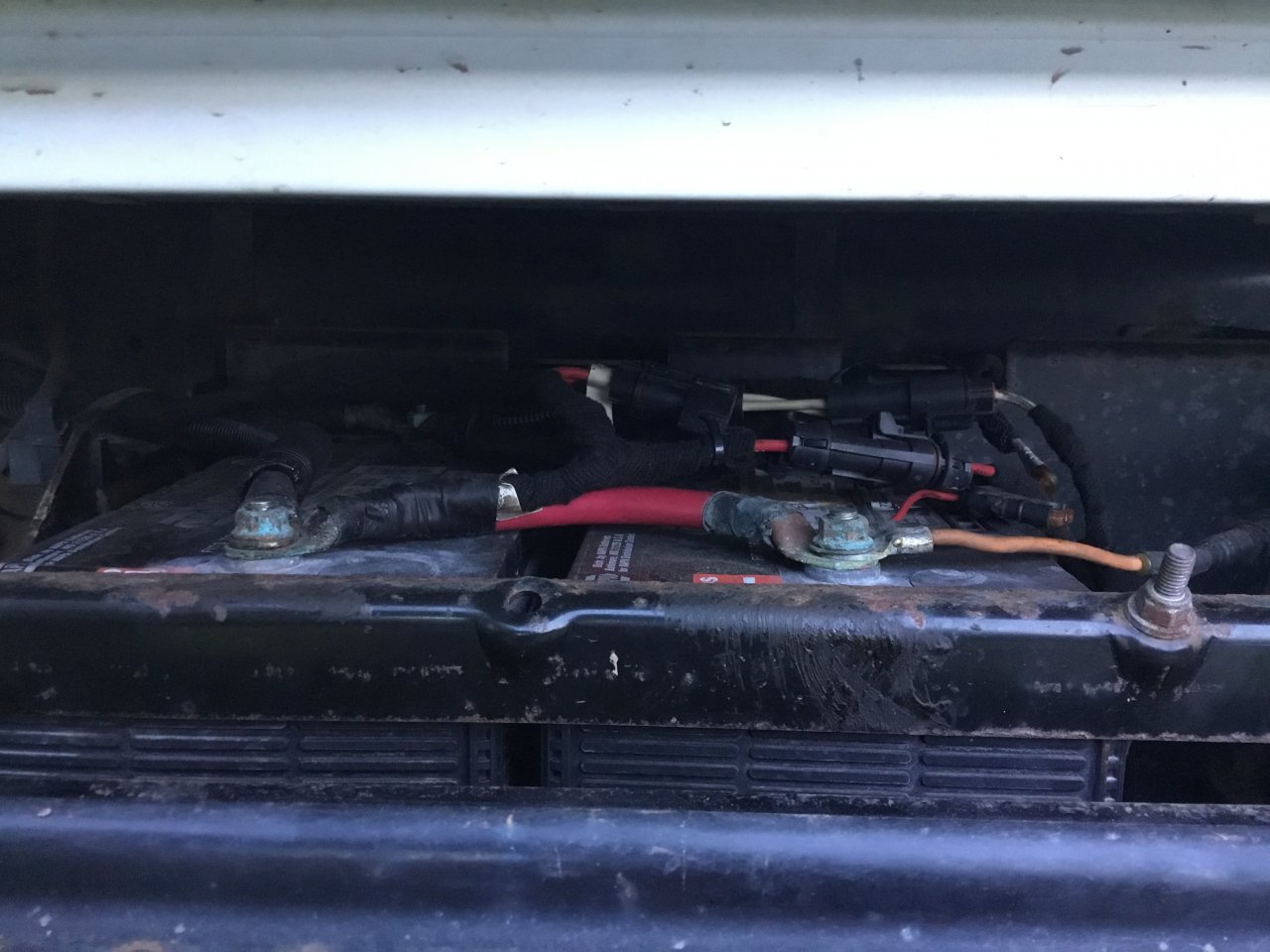

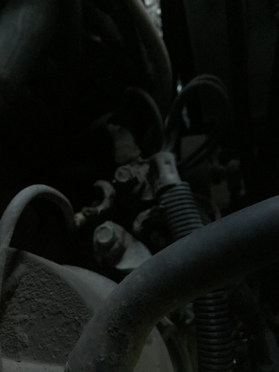

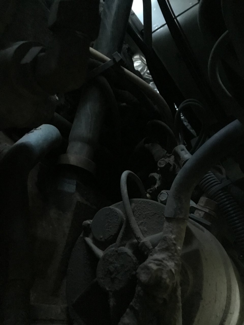

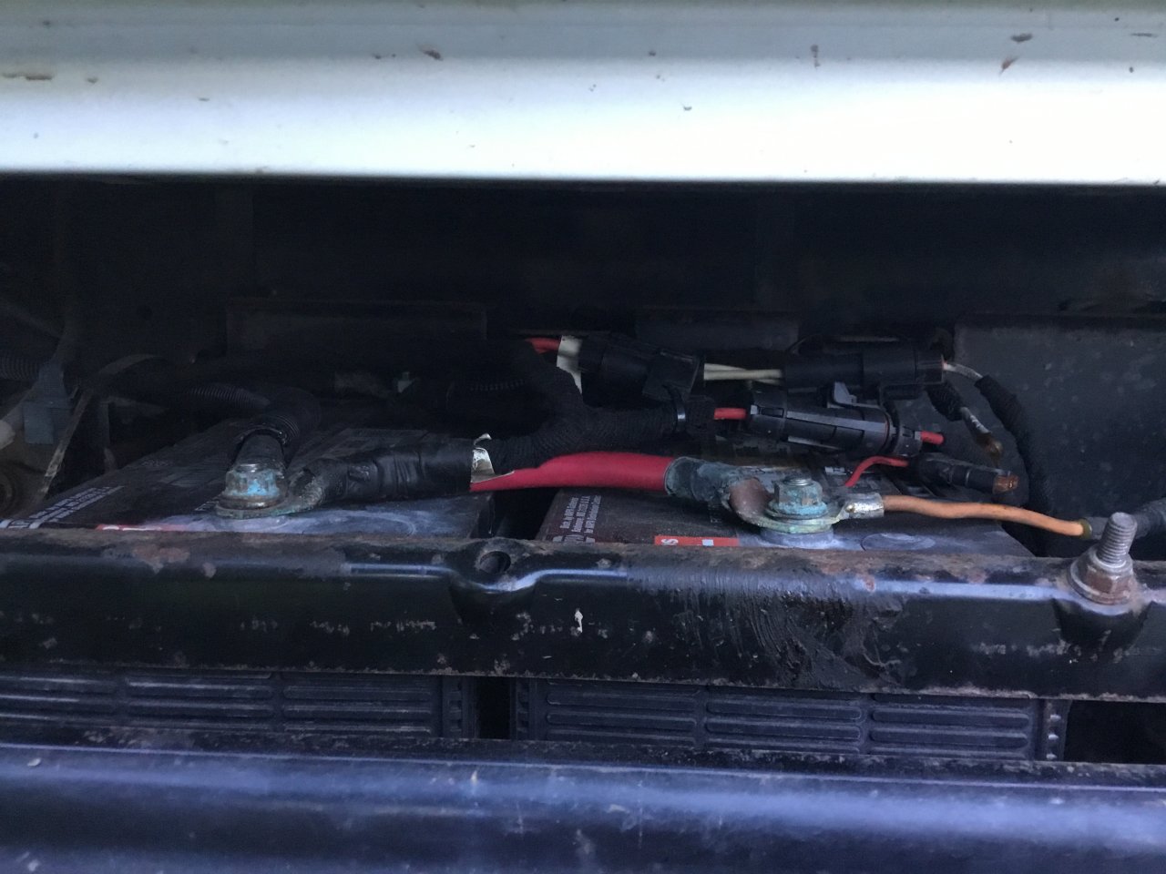

    Alright so the hot wire that's not connected... When the starter was wired wrong what actually happened was that wire wasnt attached and it was right next to the terminal and the starter housing. You can see the fuse that's blowing in the picture. Also I couldn't get a pic but there's the ignition wire attached at the relay on top of the solenoid

    You don't have a short in the harness, you have an issue with the starter itself and the wiring itself.
    The 100 amp mega fuse is there for the body and everything else but the starter. YOU should have another line going to the starter from the batteries, nothing in between. The starter line needs to be on the battery side of the fuse, not the other side.
    The starter needs to be replaces, it has a crack in the rear housing and can leak water in very easily. I haven't seen one crack like that in a long time and that one was beaten by some clown with a hammer out of frustration.
