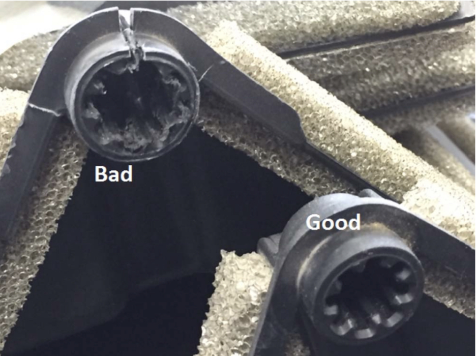

    Temp door is probably broken. Even tho the actuator moves the door can be broken or stripped inside.

    Ok, tore the dash apart. Took off actuator and the door is not broke. I can take a pair of needle nose pliers and open and close it so it’s not stuck, and the place where they usually break looks good. No cracks. Plugged actuator back in and then turn the temp control knob to make sure it works. It will only turn one direction. Plus if I turn the control to stop the actuator, it doesn’t. Just keeps going in the direction that holds the door to cold. I ordered another actuator and hoping that’s the issue.

    Mine looks like the one in the picture that’s marked good
