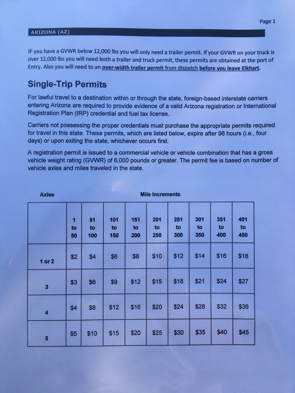

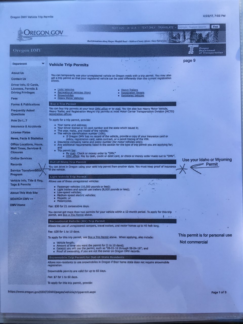

    Wow thanks man this is super helpful! Patchwork of regulations is right. And here I am avoiding IRP and IFTA to avoid these sorts of complications yet it sounds like my avoidance of them may have become the complication...
    Maybe it's worth just filing IRP and being done with it. I'll have to crunch numbers

    I'm not sure how that works if you are under 26k whether you can voluntarily register IRP or not. If you're not you can buy fuel in cheaper fuel states and pay no penalty for that if you have a slip tank. Depends where you plan to operate. With IRP you don't have to worry about the trip permits but you have to track your mileage in all states and submit a quarterly IFTA where they figure out if you owe fuel tax or are due a refund. I have not made it that far yet as everything I have done thus far has been under 26k.
  4. Brandonpdx
    Brandonpdx Road Train Member
    4,541
    4,496
    Dec 27, 2007
    Elkhart, IN
    I got curious and looked it up...you can voluntarily opt into IRP/IFTA even running 26k and under. Above that it is mandatory.
    Depends where you plan to operate as to whether it would be worth the extra hassle. If you plan to run out west a lot it probably would be. If you plan to stay in the Midwest or down south probably not.

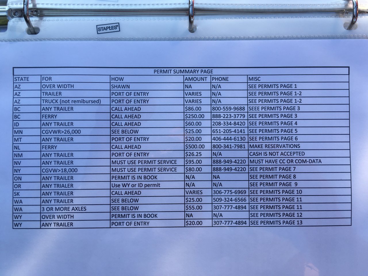

    That’s right. I screwed up last year I had IRP For decades, I’m based out of California, and I failed to run a load out of state last year. So this year when I went to renew my IRP, California told me I’d have to wait until next year before I could get it again. A couple of weeks ago I took a small load in the back of my pickup to Saint George, UT. I had to buy a permit for Nevada, Arizona, Utah didn’t want anything, might of been because I wasn’t even pulling my trailer? I think I paid $145.00 for Nevada, and Arizona. I purchased those permits through JJ Keller. Using a service, it costs more to get permits but I didn’t have time to deal with it myself. It was a expedited run.
    And that was with having MC, USDOT, etc.
    in my opinion, you’re better off having IRP, and IFTA. Buying permits on a regular basis would suck.
